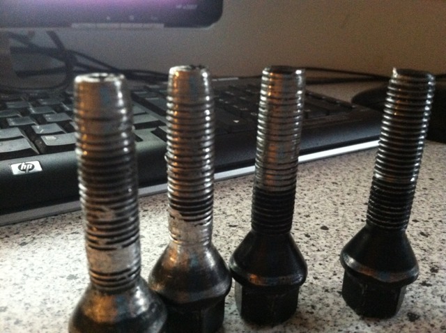

    So my lug holes stripped out still have no idea why but both the bolts and the holes were done for Click image for larger version
    I drilled out 3 of 4 holes for helicoil and ate up 3 31/64ths bits so i decided to go another route. What if i welded studs into the holes i drilled? If its a healthy weld i dont see how it could be any weaker than threading,

            Wow how did you do that to the bolts? Did you try to hammer them in?
            Originally posted by LJ851
            Feedback
            • aPapester
              • 215
              No i threaded them in by hand at first like any other bolt
              Yeah im not very pleased with those extended bolts

                  There is a fix for this, but the hubs have to come off the car for the work. You can remove the hubs (you'll need new bearings) and have the holes drilled for studs that are pressed in from the back of the hub. In most cases it will be no more expensive to just replace the hubs with new parts.
                  As to why this happened, from the appearance of the bolts I'd say that they weren't long enough for full thread engagement. To avoid a repetition, replace the hubs and switch to thread in (race type) studs and lug nuts. They are available from 75mm length and up.
