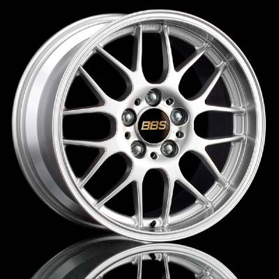

    BBS RGR Bright Silver 17 x 7 et 38mm 16.3 lbs my cost $474.50 each.

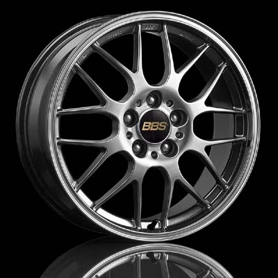

    BBS RGR Diamond Black 17 x 7 et 38mm 16.3 lbs my cost $474.50 each.

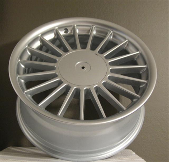

    Alpina (Kopi replica) 17 x 7.5 et 35mm 20.1 lbs price $804 all 4 shipped to my door.
