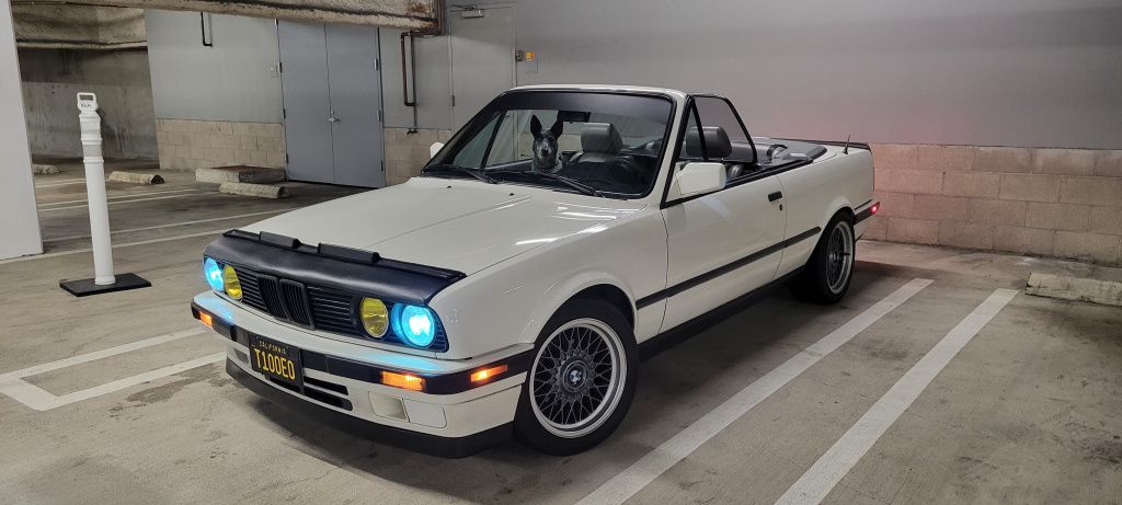

                        • arcpolo
                          • Aug 2019
                          • 134
                          i am running the same setup on my vert..Click image for larger version
