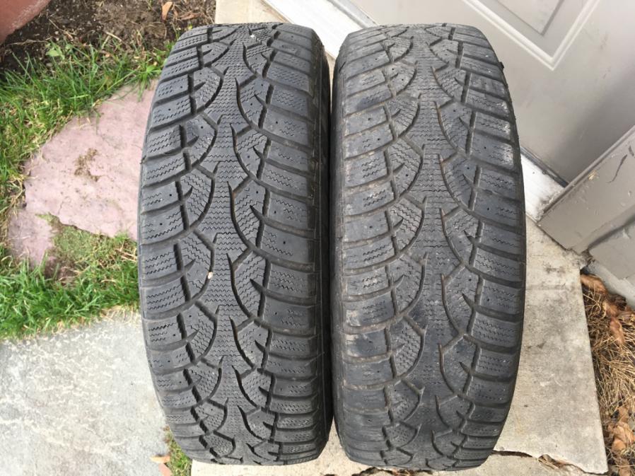

    My son's car has completely worn out the inside of the right rear snow tire. He just swapped out summer tires and found this weird wear.
    H&R sport springs, not that low. All new bushings in rear suspension recently. Altimax Arctic snows on stock bottle caps. Two winters of use. Front ones look almost new. Left rear shows some inside wear, a bit of cupping. Right rear is shot, but only in two distinct places. My neighborhood tire shop says he thinks it's tread separation - could be too much stress and heat on the inside, could be manufacturing fault. I don't know.
    Left-Right, directional snows. Right shows a bit more wear here but not bad...

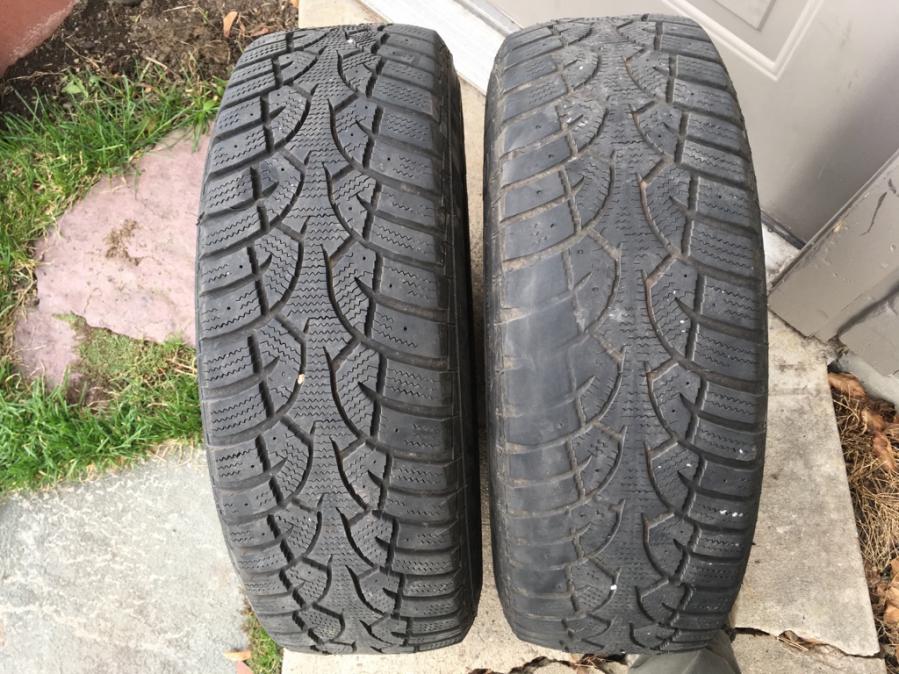

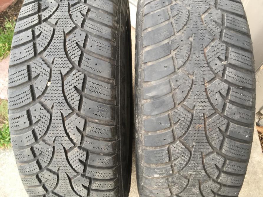

    But spin it a bit and it's completely bald. This happened at two spots, not 180º apart but random. Tire man thinks it's separating and the bulging spots are wearing down fast.

    I wouldn't think sport springs would be causing excessive camber wear. Do you think this was the suspension's fault? We don't want to ruin a new set of summer tires.
    Possible clue (?) - he did take a long trip (over 1000 mi) loaded down with teammates, gear, and 7 bikes on the car. D'ya suppose the back was squished down, wacky camber?

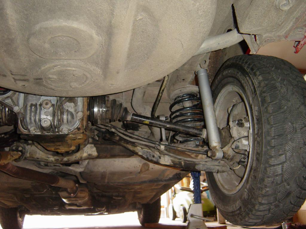

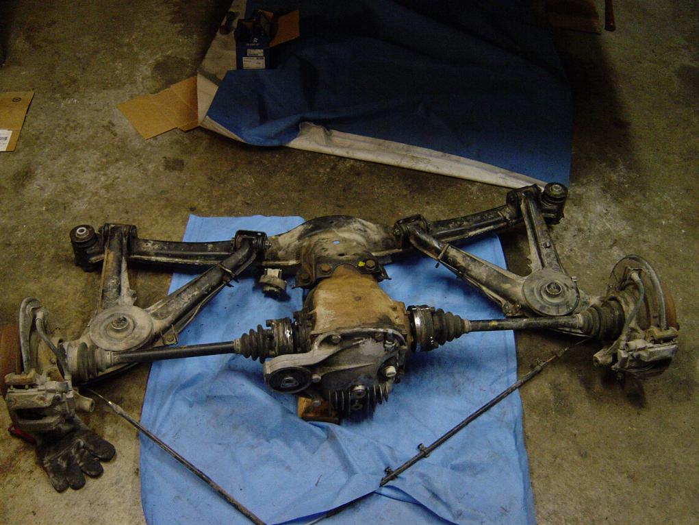

                      Just ran across the pics from when we rebuilt the rear suspension a couple of years ago. Not that they show anything revealing to me, but here are the better ones...
