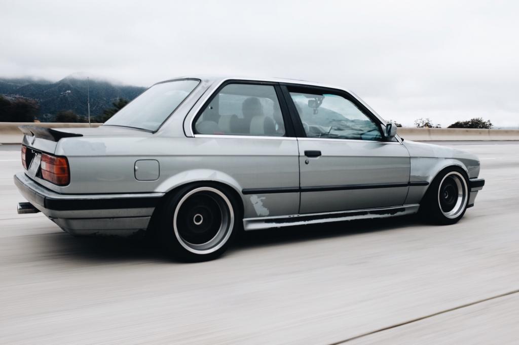

                        16x8 friends, I need your help!
                        Im looking at getting 16x8 ET10s and want to run 225/45s. I feel this may be on the hairy edge of possible.
                        What do you guys think?
                        • AWDBOB
                          hooptie connoisseur
                          • Aug 2013
                          • 4504
                          It depends on how much fender work you want to do. The front lip is small and hard to work with, so when you roll them flat it pushes the fender out pretty hard and makes it look odd in some cases. With the 215/45 on a 16x8 above on my car I don't rub up front (but it's close) at ET13. I am 100% sure 225/45s would have me rubbing (still no roll up front) and the loss of 3mm (et10 vs et13) with the wheels you want to run wouldn't be helping.

                          • masterofnone
                            • Oct 2018
                            • 99
                            Thanks for the reply Bob!
                            My fenders are rolled pretty tight and pulled ever so slightly as to not disturb the original line.
                            At a point in time I was running Ferrari 348 wheels (17x7.5 ET-1 with 195/40s) up front. I was not able to turn my steering wheel more than one rotation on a stock rack without hitting fender. But I was also going for a form over function ride height back then. Rears were 17x9 ET3 on 205/40s. Not worried about fitting rears.
                            According to online calculators, comparing the two setups, the corners of the tires should be in about the same location but the 225/45s at ET10 would be taller.
                            Untitled by Evan Nessim, on Flickr
                            Pics brought to you by Miss Courtney Cutchen.
                            These were my style 5s with 5mm spacers front and 205/45s, no issues for sure. I plan on raising the car even more to allow clearance for Z3M diff cover vs. speed bumps.
