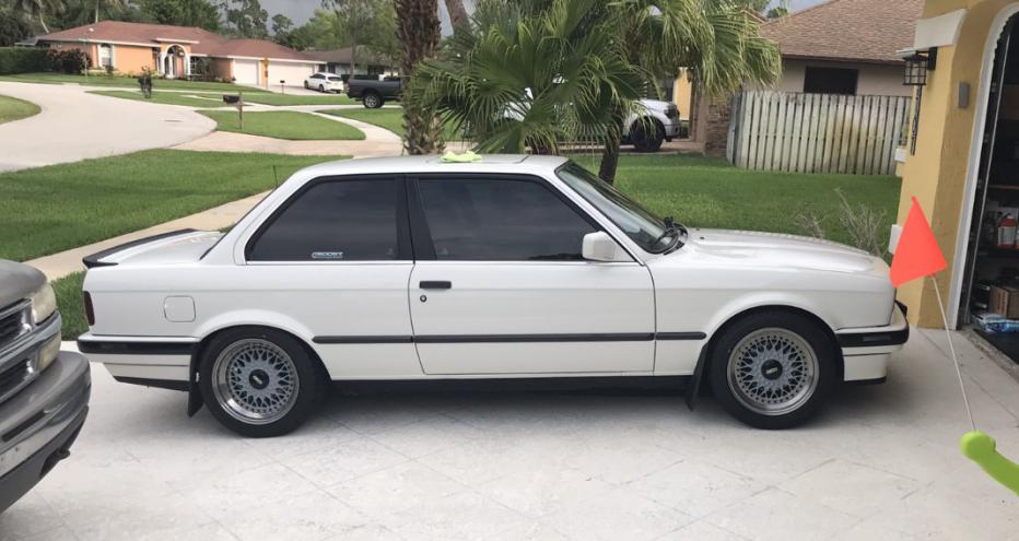

                        Car: 1988 325i convertible
                        Suspension: KW V3 coilovers
                        Wheel: BBS RS Reps 17x8.5 et15 all corners
                        Tire: 215/40/17 or possibly 225/40/17
                        Can someone confirm this will work without any rubbing? Do I need spacers??
