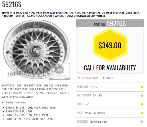

            #9725
            I am looking for better fitment of my 225/45/16 r888r tire on my 5 lug swap car. I am currently on style 5 16x8 +25 and it is not enough offset. The tire rubs the fender very bad and I could only run this setup with a lot of camber or lifted max or maybe higher on my ground control coilovers. I have found a new wheel I like but it is either fake or hard to find. Can someone help me find the z3 bbs 16x7 5x120 +45 part number:36111180410 or part number:1180410? I have found this wheel on two refurbishing websites but they do not have them. Any info or correction on my research would be appreciated.

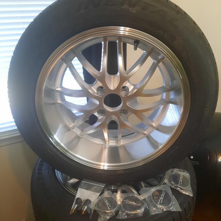

                          • Whit3 E30
                            • Dec 2013
                            • 117
                            #9733
                            Originally posted by Whit3 E30
                            I'm about to try out ARC AR3 16x8.5 et20 with 225/50 on, 84' 318i with 91 318is suspension swap all around, fenders rolled with H&R sport springs with Billy's, wondering if I need camber plates
                            Finally my wheels came in, now need a decent weathered day for fitment R&D, had to trash picture quality for me to be able to post it here
