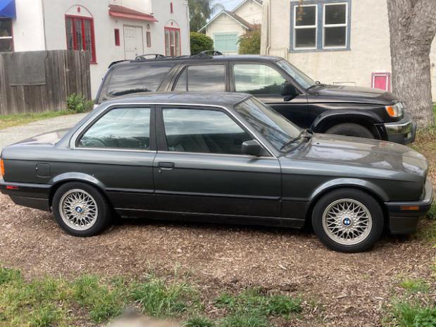

                      Hey folks,
                      I'm getting ready to buy new tires. Currently, I've got 205/50s on 15" basketweaves. My car is on H&R Race springs, E90 drop hats, and a 15mm riser pad in the back to reduce the saggy rear end look.
                      Anyway, I was thinking about trying to find some 0205/55s, and wondering if anyone has any experience here? Am I going to rub?
                      I'm looking to get rid of that wheel gap, and wouldn't mind some meatier tires. Current setup picture attached.
                      Thanks!
                      • nando
                        • 34837
                        #9716
                        205/55R15 actually matches the stock E30 rolling diameter (23.9" or something like that). It shouldn't rub. There are more tire options now than I thought there would be too.
