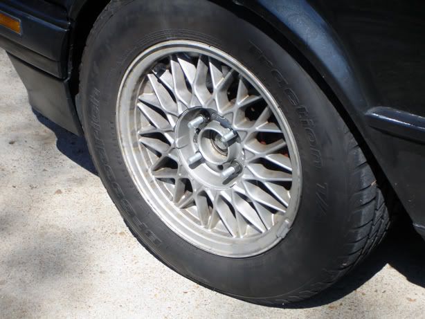

                    • E30Driv3R
                      • May 2004
                      • 1169
                      This is the best pic of the 80mm on stock wheels. mastcruse is right, you cant put on center caps. i didnt like the way it looked at first but it is kind of growing on me. ill get better pict later today
                      edit: Nevermind i found one.
                      Dan Zickel
                      1995 M3, 1991 318iS, 1987 325iS
                      • Jand3rson
                        • 37587
                        That just looks ridiculous to me. It looks like what it is, like your wheel studs are way too long.

                          • Schnell 318
                            • 567
                            Yeah, that pic settles it, 50mm it is.
