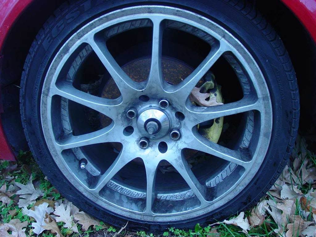

                          Originally posted by AlarmedBread
                          Am I the only one who prefers bolts?
                          I have studs on my parts car ;)
                          http://img.photobucket.com/albums/v3...d/DSC00002.jpg
                          Noob!
                          Spacer + bolts = , I now have studs.
