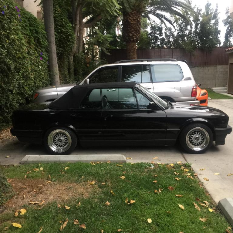

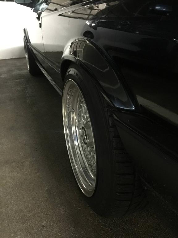

                      • Mike36
                        • 1079
                        #1091
                        Originally posted by EfrenFlores
                        Anyone have pics of RS001 16x7.5 mounted? Im in the mood for some BBS porn pls share!
                        RS001
                        16x8 ET14
                        16x9 ET14
                        Lower in the front now.

                        • bradnic
                          • Jul 2012
                          • 3551
                          #1092
                          Originally posted by Mike36
                          RS001
                          16x8
                          16x9
                          Gorgeous
                          How did you get 16x8 to work in front without poke?what ET?

                          • Mike36
                            • 1079
                            #1093
                            Originally posted by bradnic
                            Gorgeous
                            ET14 both front and rear. Fits perfect without any poke ;D
                            • bradnic
                              • Jul 2012
                              • 3551
                              #1094
                              NICE. more pics please.
                              closeups?
                              please
