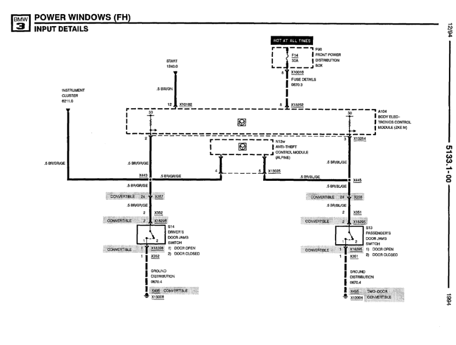

    Never mind. Look what I found: Click image for larger version

      It's a euro feature called a Comfort relay.
        That's super interesting I've never heard of it before. How is it supposed to work?
        It could be neat to retrofit onto a US car for fun.

          I didn't know about it either until I got my 323i. It supplies +12v for a period of time after the ignition is turned off or when a door is open. So basically, once you open the door you can control the windows/sunroof without the ignition being ON. Useful, if you forget to close one of them. I guess the comfort part is not having to switch on the ignition for power. Not sure why E30's didn't get this feature in the US.
          Supposedly, the relay is located by the accessory box under the dash. I doubt the wiring for this is there in the US cars but it shouldn't be too difficult to retrofit one. My ETM's are all US car based so I'd start with finding one for a euro spec car.

            I'm sure some of the wiring is missing, but I bet it would just take a patch cable to get it to work. First step is finding a euro ETM.
