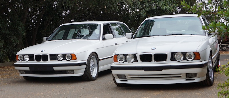

        Hi Luke,
        I am running GC on my 540. They use to clunk when I turned a corner going slow. Recently I changed the springs and lubed up the mating surface and the clunk is gone. They seem to work well on my car.
