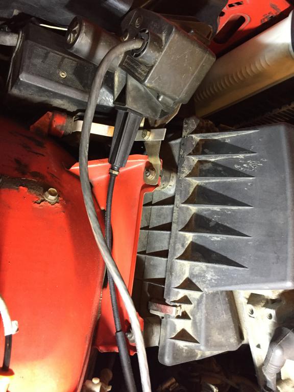

        It doesn't have it's own hole. it mounts to the stud that holds the airbox to the bracket, which you can just replace with a bolt if you don't have the airbox anymore. actually I think there's another piece the OP is missing from the cruise control module. A flat bracket that screws to the CC module, which then attaches to the airbox. I don't have the stock airbox, but it works the same.

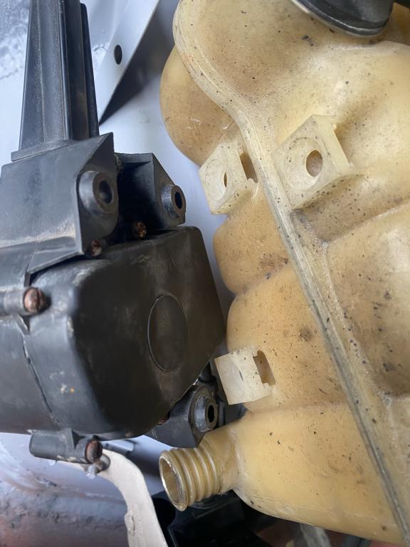

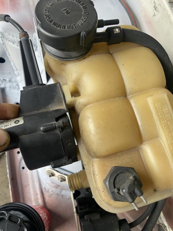

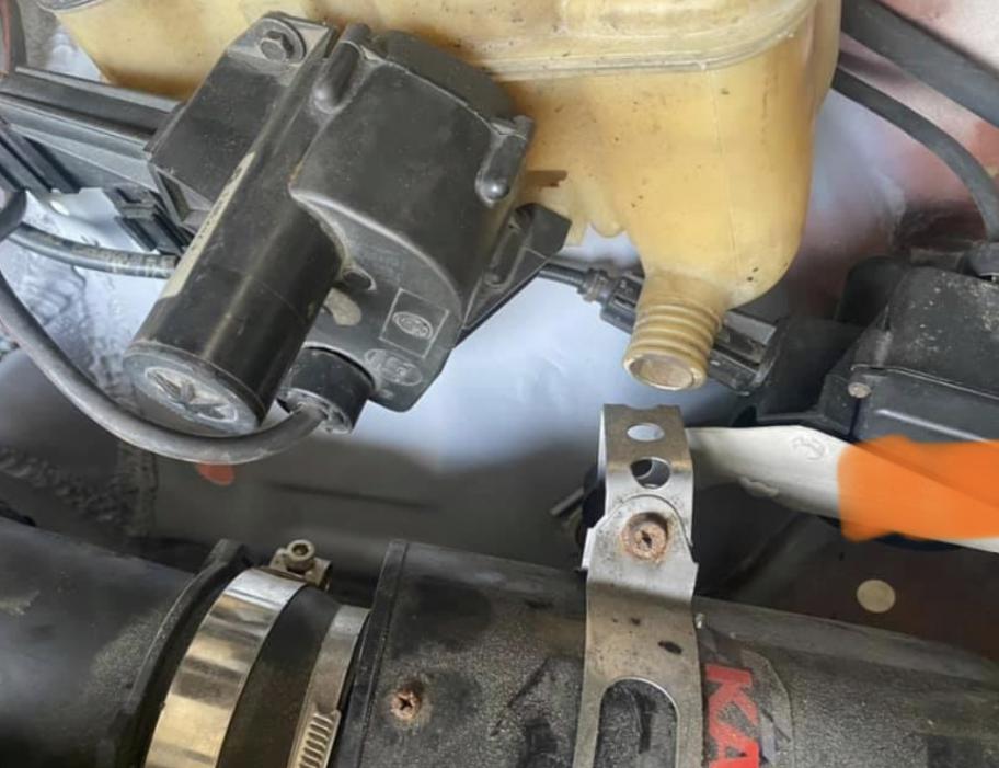

                    You can see in this photo how it does mount to the tank.
                    It’s hard to see, but I also have a custom-made bracket that I made by reversing the stock cruise control mount, putting a bend in it, and welding a former coil mounting bracket onto the inner fender after adding a second stud to it.
                    After spending all that time Fabin that bracket, it was brought to my attention that you could mount the cruise on the side of the radiator expansion tank
