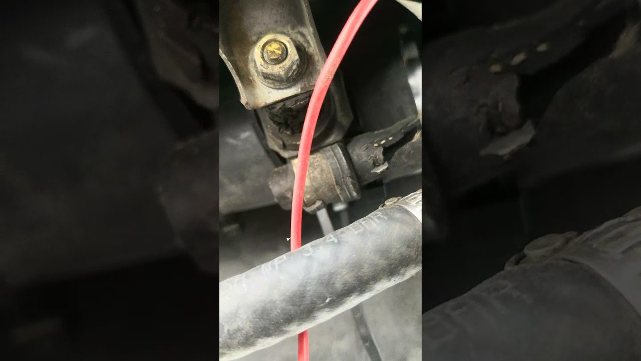

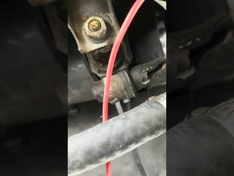

    I'm hearing a weird noise at around the fuel pump. The car hesitate under load in 1st and 2nd gear. Wonder if it's a fuel pressure issue ? New pressure regulator is installed in the engine bay.
    Attached it a quick video I recorded while the engine is at idle.
    Thanks in advance for your help.

    Bit hard to tell but it sounds like its cavitating. which sort of implies that its either sucking air or trying very hard to suck fuel and not getting any.
    Does your car have an intake fuel pump as well? i can never remember which ones do or dont.
    maybe the fuel pump is just stuffed, or the internal one is stuffed (if it has one)
