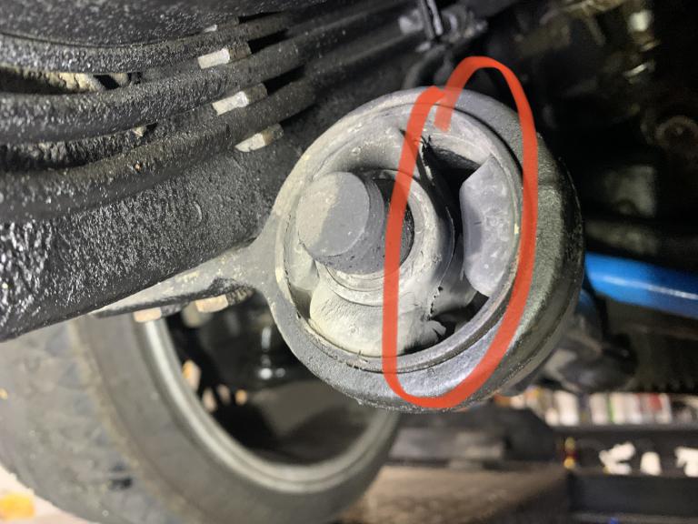

    Hi,
    are these specific to the sides like left and right or one fits both?
    also is it better to buy the whole assembly or can they be easily be pressed out and in?
    i suspect mine is rubbing here as I get rubbing noises.
    new shocks abs everything else is mint.
    thank you
