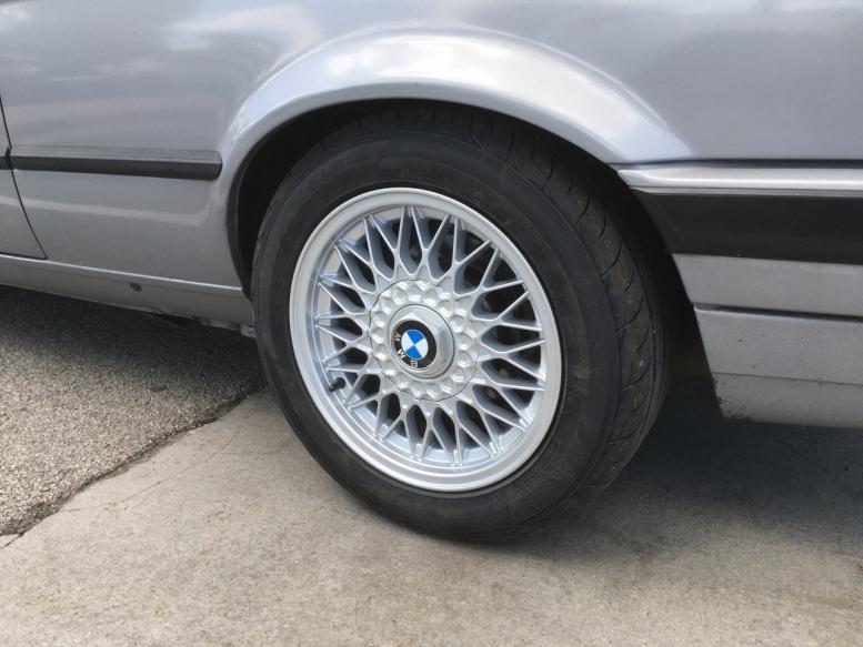

                      Haven't had a chance to get her to any scenic locations, but here's a couple!
