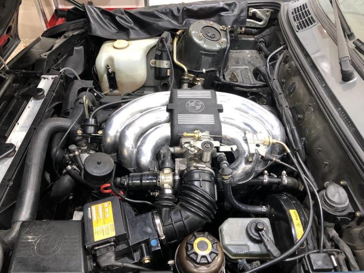

                My Covid project was polishing the intake manifold. It required about a hundred sanding rolls.
