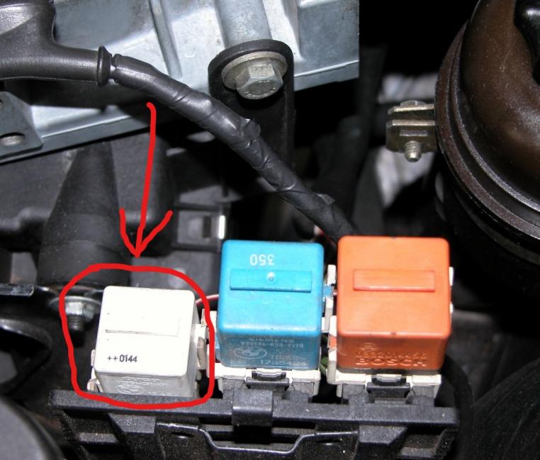

        Check your DME Relay. I had this relay die on me and it caused a no fuel issue as well.
