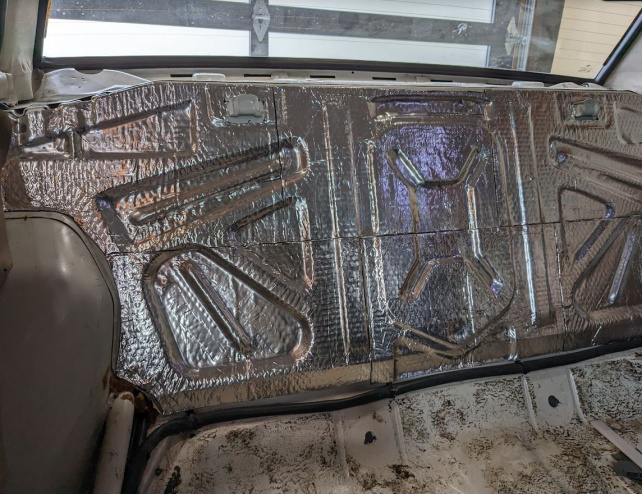

      It seems like 90% of my noise comes from the back (I have absolutely nothing in my trunk anymore...) I'm applying some Noico 80mil
