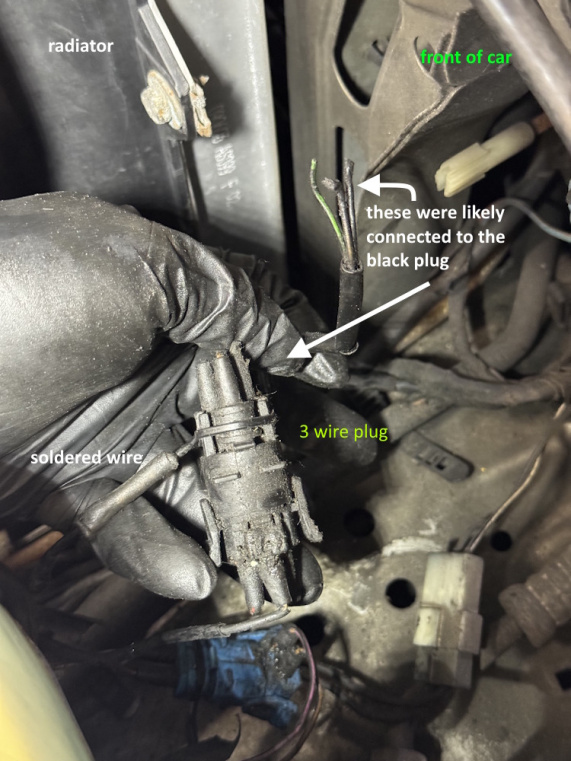

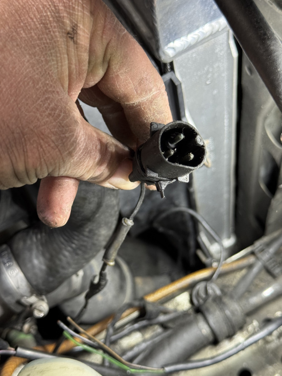

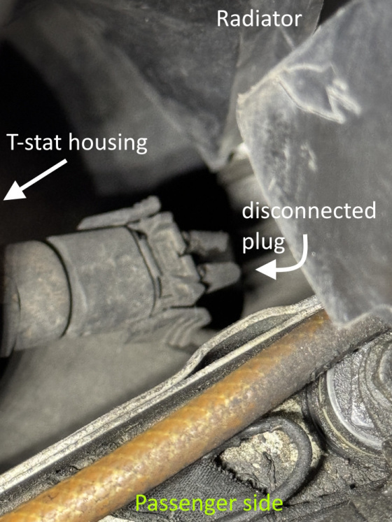

    That's said, on the other side of the engine (passenger side) just behind the headlight plastic cover, an amateur did some damage... There's a black 3 wire plug that was hacked into. There is one single wire that was soldered on to this plug and it goes down along the engine block. At the moment it's hard to see where it connects to... But it goes near the thermostat housing from what I can see. More details to come...I suspect a couple things... Maybe the new aluminum rad is missing a temprature sensor and this plug was disconnected, but connected elsewhere to potentially cancel a CEL or something... I also noted what looks like a temperature probe on the t-stat housing behind the radiator with both wires coming out of it cut. There is a blue connector beside the black 3 wire connector that doesn't seem to be used... this is potentially the one that connected to this temp probe...I'm not sure. Those are all things that needs to be confirmed. (see photos)
    Anyone has information on aluminum rad install that could point me in the right direction? Does the proceedure state that we need to disconnect or move wires around ?
    Thanks !

    The bottom pic is the aux fan switch. If it's disconnected and the fan works, you know they bypassed it. The top pic is probably AC related.
    88 M3 - LACHSSILBER
    89 M3 - ALPINEWEISS II

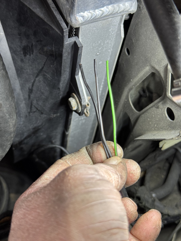

        This is the black plug with one single wire thats seems to go down the the AC.
        The other picture is the 3 wire pigtail that was cut. If anyone know where these should connect to, that would help.

          Pretty sure that's AC, like compressor clutch and whatnot.
          Aux fan wiring is on the other side of the car (like the connection to the fan).
          I don't know where the fan temperature switch is on the m3, but it could be this wiring.
          Try to find a copy of the ETM and check wiring colours.
