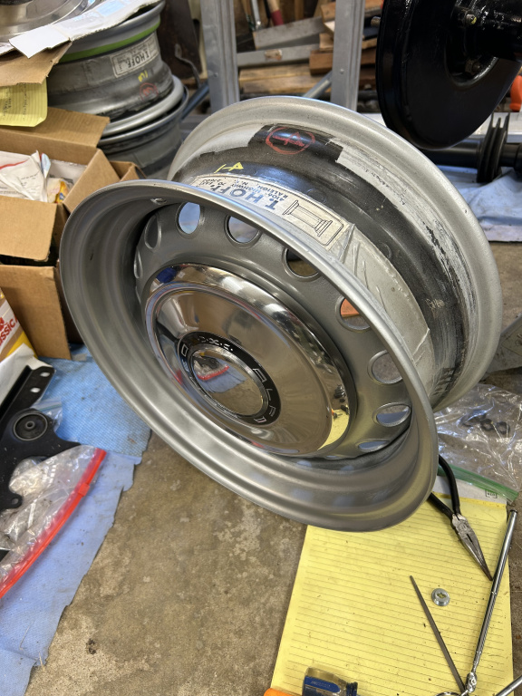

      I snagged a set of 6x15 banded original wheels, done by a good machine shop in NC in the 70s . Still have the tags inside, I didn't paint over them. I'll keep the skinny original 4 1/2 x 15s (that's a motorcycle wheel!) for...whatever...
      Painted in 2-part BMW Polaris Silver, really close to original.

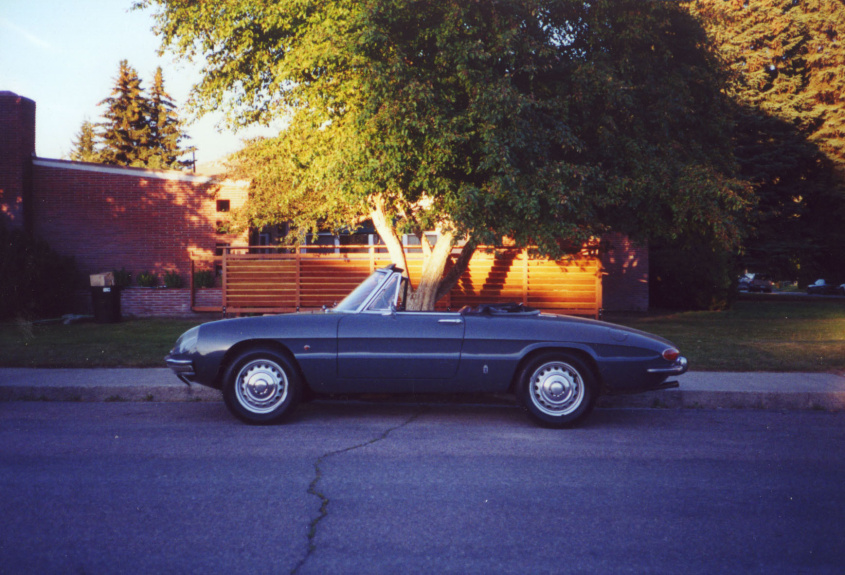

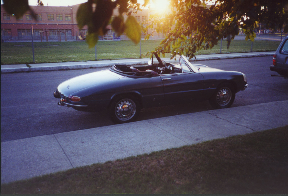

      What it used to look like before the trunk lid smack and disassembly - This is after years of daily commuting in Seattle. There were some rust bubbles to resolve before painting.
