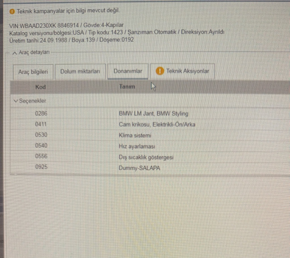

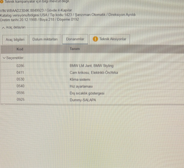

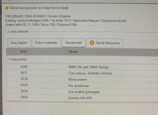

    Hi everyone,
    I'm looking to connect with US-Spec E30 325i owners and enthusiasts who are familiar with ETK / VIN build data.
    I have a factory-original 325i with a specific factory sunroof setup and option combination. As we know, US-spec models come with unique factory configurations and option packages. I want to compare ETK build sheets, option codes, and technical details regarding the factory sunroof setup on these North American models.
    If you own a US-spec 325i or have deep knowledge of ETK factory build data, please reply here or send me a PM!
    Thanks!
  • yusuf325
    • Oct 2026
    • 8
    Almost all of these US-spec E30s actually have factory/dealer sunroofs installed in reality, yet the sunroof option codes do NOT show up in their ETK / VIN build sheets.
    I know this is a common occurrence on North American models (often due to standardized US trim levels or standard fleet packages). I would love to hear from ETK experts and US owners about the underlying reason for this discrepancy in the factory data!

        Thanks for sharing your options list and details! Just to clarify my point: I’m not asking whether 325i/is models came with sunroofs or how options were bundled in the US market, but specifically about the ETK / VIN build sheet discrepancy. As examples, here are three different 1989 US-spec E30 325i Sedans listed on Cars & Bids (https://carsandbids.com/auctions/rk6...bmw-325i-sedan , https://carsandbids.com/auctions/rMx...bmw-325i-sedan and https://carsandbids.com/auctions/KZj...bmw-325i-sedan) which all physically have manual (crank) sunroofs, yet their official BMW ETK / VIN build sheets do not list option code ⁠400⁠ (Manual Sunroof) or ⁠401⁠. My main question for the ETK experts here is: Since sunroofs were practically standard equipment on 6-cylinder US-spec models, did BMW log manual sunroofs as Standard Equipment (Serienausstattung - which doesn't appear as an SA option code in ETK) for certain production runs/models, or is this simply an omission in the factory build database? Has anyone else noticed their factory manual sunroof missing from their official VIN build sheet?

          When I called my BMW dealership for my full options list they told me that 401 was one of them, and one of the online ones say it was an option despite it being 100% standard on my car. To compare I ran the VINs of a few manual-sunroof examples from BAT through various decoders and they all turned up no 401 and no 400, so I'd put five bucks down that BMW just had manual sunroofs as part of the default US spec standard like you speculate.
