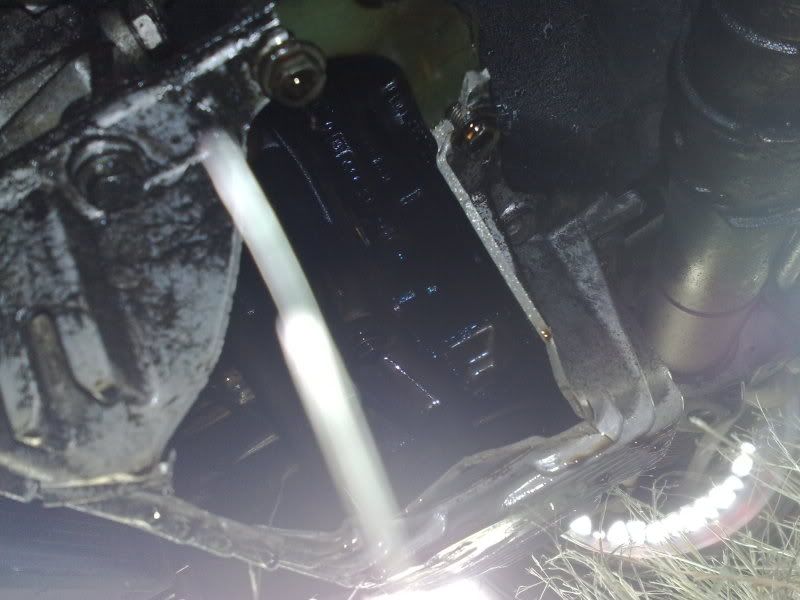

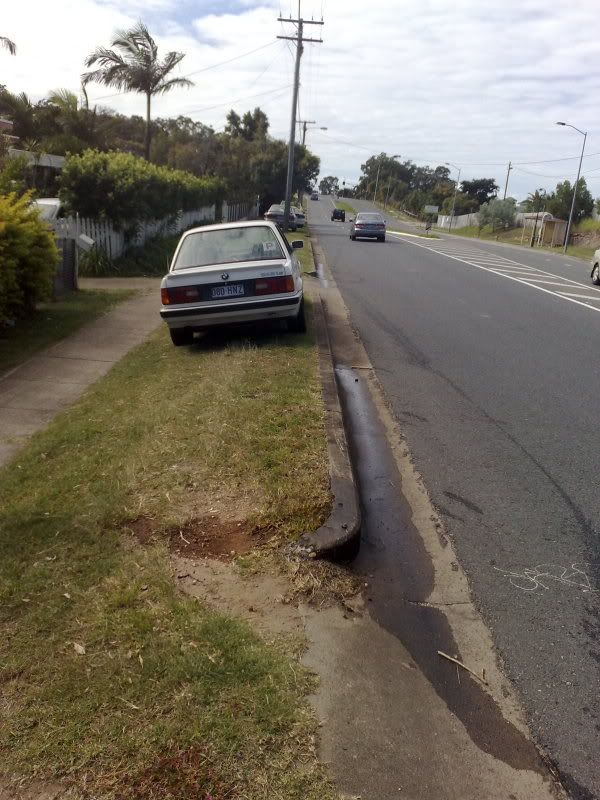

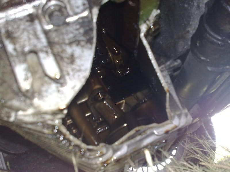

    well this is the first damage that ive caused to my e30, rather plane case of stupidity on my behalf, just didnt realise how much of a slope was on the footpath!
    is it just the lower sump? i really hope it is, i havent got the time nor money to buy a lower and upper!
    any input is greatly appreciated!

    Yowch. Hope you shut it off right away.

      bloody oath i did!, reversed out, then rolled foward and turned her off!

          looks like only the lower..

                  As for your cracked upper pan, if that is what I see be sure to groove it out and put jb weld on it then a little sealant.
                  Dont forget to go ahead and check all of your upper pan bolts also.
                  If any are loose put locktite on it.

                    a crack?????
                    where do u see a crack??

                        i do see the area you talking about, i really hope its not!

                          I hope you can get a lower, I have one in my shed just waiting for when the road claims it.

                            oh yea ill be able to get a lower easy as. just go to wreckers! or order one from somewhere.

                              Does look like just the lower however.
