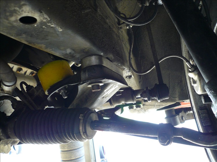

            Out of curiosity how did you setup the front subframe to clear the oil pan and the hood? Was that the reason that you removed the intake?
            I'm doing the exact same swap into my car.

              the best way IMO is to lower the subframe .. complete like i did,, but i repeat this is my opinion
              20 mm alu adapter
                  Originally posted by s38e30
                  I lowered the subframe about an inch for additional clearance with the hood, but the downside is the original kit does not do to much for it.

                          notice any major change in suspension geometry? I'm still up in arms on how exactly I want to get the engine in there.

                                I am doing the same swap and from research and what i've done the 20mm spacers is the way to go and it doesnt look like the geometry changes much.
