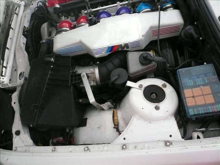

    The engine drops right in with a set of motor mounts I found in Germany (not the set from 300mm.de. The hood cleared the intakes and the pan cleared the subframe, no problem. I just wanted to lower the engine a bit and give room around the tunnel for clearance.
    The 20mm spacers did change the geometry of the front. The camber plates turned into caster plates for the correct placement of the wheel. Even with the Late M3 control arms and the treehouse CABs, the wheel sat a little further back.
    The Z3 steering rack fit right in without the modified linkage. Bonus except that I purchased the stock US linkage thinking I would need it. The standard European linkage just fit right in place.
    The ECU is using the Alpha N stup with tps and Map. Slight torque loss but the 3.8 cams and gears shifted the curve down.
    Price of the motors (I bought 3 at one time) was roughly 2500 euros total (~$3200) for all three including factory ECU and all acc. expect A/C. Like I said, this swap would not be feasible in the states because of the cost of one motor. I have had 2 E34 M5s in the States and parted them out. Each motor sold for ~$5000 complete.
    I am still building this beast. The setup is not complete and she is not running yet.

      Sold one of the motors for 1200 euros to a friend in Germany when I first bought them and I kept the other 2. All three had under 100k kilometers and the cars were complete before we completely stripped them. I still have another set of seats (grey manual leather) and brakes from the M5s. I paid for one motor what most pay for an M30 in decent condition. That's why I decided to go the S38 route instead of the M50 or S50. Shear cost and the affordable wow factor!!!!!!

        At this point, I am not overly worried about the loss of torque. I will have to find a dyno to dial it in correctly and if I find I loss a lot of torque, I will switch over to the carbon airbox.

              I am using the M5 rad in between the grill and support as well with a dual (push and pull) electric fan setup and the factory oil cooler mounted below it. (No high beam lights just ducting if side to side clearance is not enough).
              I was going to use tino's mounts from 300mm.de but found another set from a small company in Germany that were made to clear the headers without modification to the mount. I did get the spacers from him though and they fit beautifully
              For trans, I am using the 535 until I get back to the states and located a good E30 M3 trans for less. I have had 2 M5 transmissions break shift forks, so I do not want to waste the time and money using one. E30 Ms are expensive if you can find one in a yard here. States side, they are about $500 usd ---- much more reasonable.
