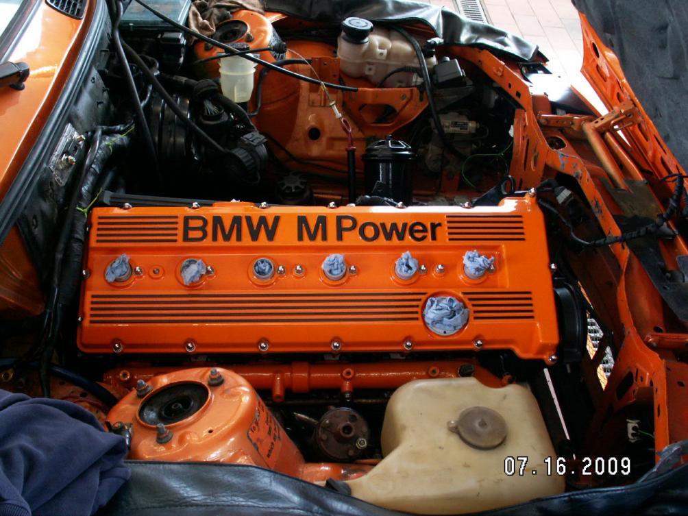

I love orange in the engine bay!

The orange reminds me of Jagermeister race car :D1990 Islandgrun 535iM Sedan
