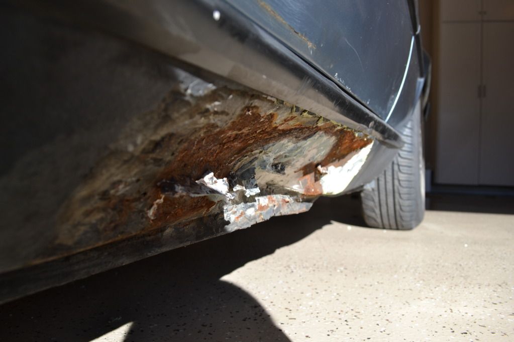

  • tytypetersen
    replied
    Project Convertible is just fixing POs stupid things. The PO before PO took good care of it. But PO destroyed the car in a few years. Engine was overheated and probably kept driving it. Engine was toast. IS front air dam was ziptied on. Dents and scrapes everywhere on the newish respray. 70 sidewalls on 14s. He sat on the redone seats with a "knife" and ripped the perfect seat :hitler:.
    The worst body damage was on the rocker panel. We bought the car and it was cracking a bit. We chip away... maybe about 3 inches deep of bondo with nuts and bolts as filler for the filler... But car is straight thankfully.
    Most these problems fixed now though.
    Leave a comment:
