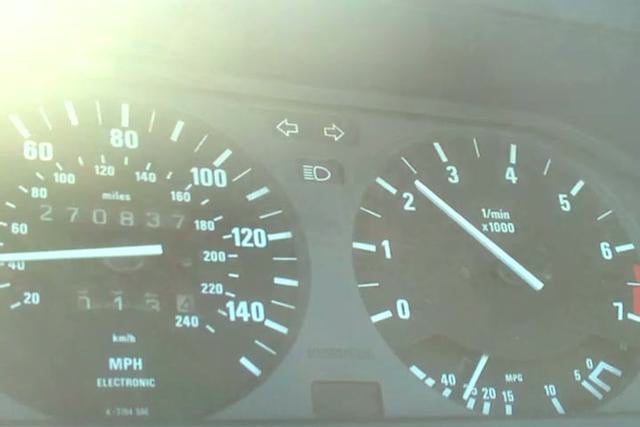

      I'm still not sold on the m50 swap. I did one recently at my shop in a friend's car, then did the 885 top end and Motronic 1.3 in my car. The m50 went in an 87e and my car is an 86 es. Neither of us swapped gears or trans (both 2.98 diffs, Getrag 260's). We have yet to race since he goes to NY for the summer and I just finished mine, but have proof of both on video, and drove both cars of course since they were done at my place haha.
      Here's the video of his car. For fair comparison (timing of the vid start is off), his car is at 10mph at 0:02...
      and here's mine, 10mph at 0:04...
      his hits 60 at 0:10 and mine is at 0:11. I'd say the stroker is a close run for the m50, maybe I'm crazy?
