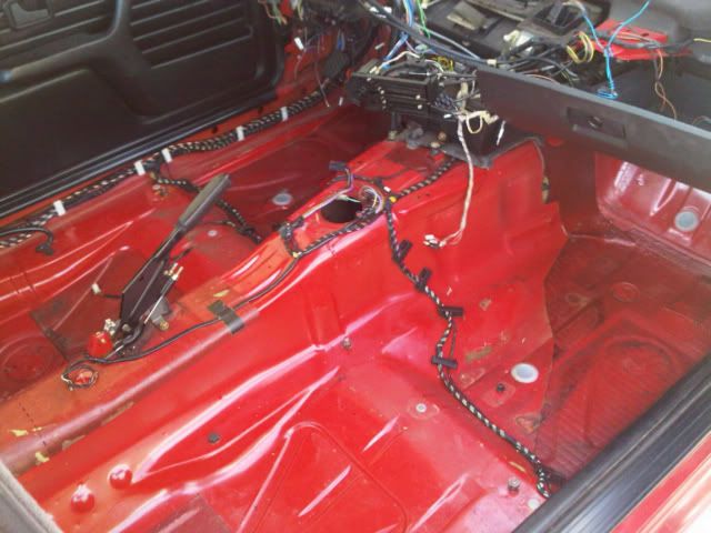

    Hmm.. Do I see pavement thru the floorpan? To me it clearly indicates major rust issues. Which defines a rustbucket as it is not just surface rust but major weakening of the structure. Just because the paint is shinny on top dosn't mean the car is solid.

      Originally posted by Zaun
      There was no soft spot in the floor and definitely no hole in the floor before the fire happened.
      So the 1 square foot hole appeared just by magic? I suspect it was hidden behind bondo or tar. Fire that you can extinguish by tapping on it with you hand while driving will not make such a hole on the pan's heavy steel gauge. Some shady shops or previous owners are experts are selling cars of questionable safety by hiding rust in many ways. And don't worry, we have all fallen for such a car. I did. You did. Lesson learn. ;-)

          #49
          He, he. I don't believe in magic. Which is why the description of your problem points to a pan that had a major pre-existing rust hole, hidden with bondo or tar (if you say you didn't see it before), with the hot exhaust igniting the plastic and the foam pad.
          Compare a picture of a clean floor pan sprayed with paint, and your picture - pan should be red. Seems your pan was bathed in rust protecting tar, which indicates a previous "condition". If the rest of the car is fine, then you could cut apart a pan from another car and do an expert welding, but most likley even the frame rail may need changing.

            #50
            dude,
            it is highly unlikley that that hole was caused by a fire.
            Lee is almost certainly right about an existing rust hole, that is not to say im might have been covered with undercoating or some shit.
            I have seen holes in many things patcher over with body filler, tar, you name it, and any of these things could be flamable.
            metal would not burn at that low of a temprature.
            more exhaust heat from the cat, could have been a cause of igniton of the "patch".

              It is not always pleasant to be told the bad news. Which makes it worst for the messenger. Don't shoot the messenger, cut old rust and weld new steel
              That car may have a few more years in it. BTW My first e21 had two square wood boards under the foam carpet, held to the pan with bondo... I was young and fell fo the shark nose and shinny paint.

                    its all good. I just woke up and shouldnt of posted tbh. I think i just took your statements the wrong way. and got butt hurt :P . Once the insurance comes out i will pull the rest of the carpet up and see what damage we are looking at and go from there. It may be a simple cut out weld up, splice wires,fix exhaust replace carpet. Or it may be find a clean body and swap everything over. Either way im not doing anything till insurance comes around.

                      If you are handy with a plasma cutter, it should be easy to cut a good pan out of another e30 and cut the exact same shape on your car, then proceed with a butt weld with a TIG. Now take a screwdriver and probe the rear passengers and driverside pans...
