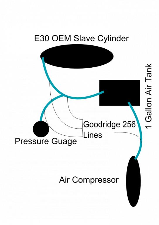

    So parts list.
    - Guy to help me!
    - Compressor. This would be great - http://www.viaircorp.com/OnRoad/100C.html and only about $90
    - Hoses. Well I am doing this quality right! Goodridge seems perfect! I just don't know which one of their products to use. Help?
    Electrical - Im talking solenoid valves and switches... $30 or so right?
    - Tank. This would be easy to find.
    Figure $90 for compressor, $50 for tank and $30 for fittings and $30 for electrical and Im at $200 even!

        #108

            Air is easier I think. Because I can just have a blowoff valve to let slave cylinder back out. Forgot to add that in the mock picture.
            So are you saying use a M/C Master cylinder, mounted on shift lever, then a line directly to slave cylinder? Okay but I think it would need more power.
            And to fix that problem run a hydro line? What?
            Or I could get like a geo metro brake booster and use it to boost the motorycle master cylinder?

                        Well I think what I need is a slve cylinder to mess around with. Or a master.
                        Because the way they work is the hydraulic fluid goes in pushes the piston, then the piston's resistance pushes it back out. Correct?
                        If I take my air design, I forgot to add these in the sketch.
                        TWO solenoid valves. One a foot away from a tank and one right by the slave.
                        First one would allow the air to reach the slave and push it in. Second would be a blowoff. THis is why I like air, you always have more than enough.
                        So they would work on a 3way button. Like on a camera.
                        With button in udle postition both are shut. Push down half way (to begin shift) and the first valve would open, disengaging the clutch. Push down all the way and then the first valve would close and second one would open, allowing the pressure to escape and the clutch to engage again.
                        Also I would put a pressure guage off the tank and mount by the ash tray or wherever to monitor my psi.
