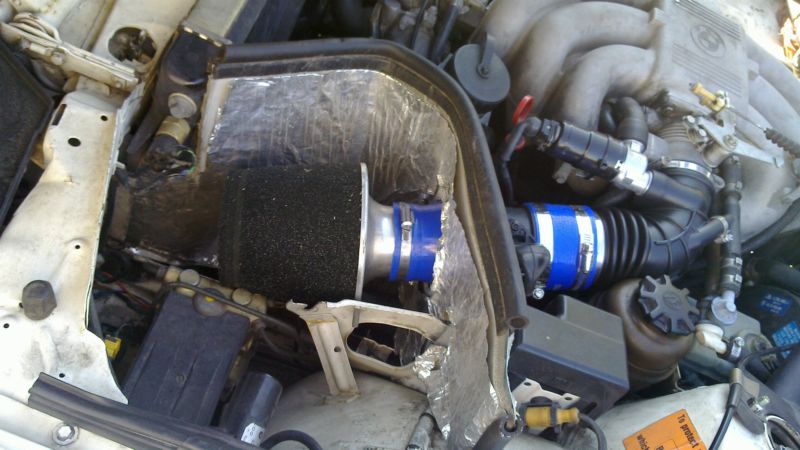

      where did you get that setup? make it yourself? one day I will finally finish my intake..
        Castros makes them.
                            Custom made to fit with fiberglass and such.
                            My buddy made them and sells them to go with his maf kit for m20 guys.
                            Castros is his name on the forum. Should I get you a quote?
