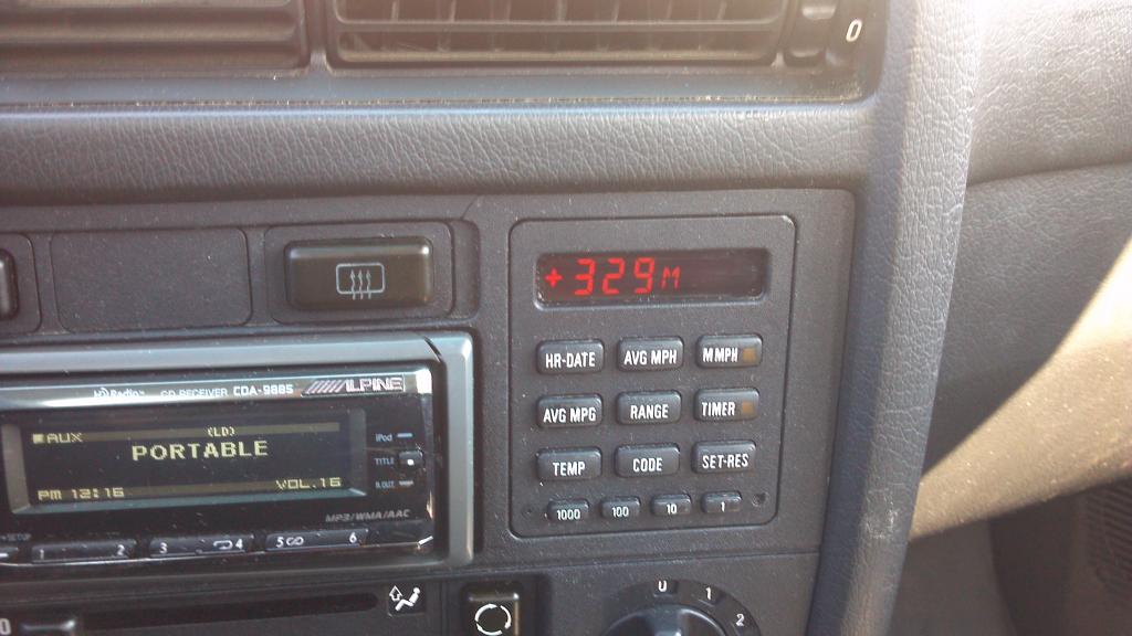

    I just swapped in an OBC.
    I filled my fuel tank today and the display reads +329. also before I filled it, I was almost on empty and the range was around 31, and INCREASED to 35 as I drove!!
    In my owners book it states that any number shown in the OBC range display with a + in front of it, indicates the tank is overfilled by that much. Im not super picky but id like to get this OBC to work at least a little bit accurately.
    The obc came out of i think an 87 325i, according to the coding plug in the back of it. a chart i found online shows a different coding plug after 87.
    If I get the correct coding plug will my range function work correctly?

    I got that too usually.
    the +329 means you can go over 329 miles/kilometers on the current tank of gas.
    Also, the range can go up from driving slowly and conservatively. The range is recalculated often so it'll fluctuate from your current driving habits.

      your obc is fine. if u fill the tank and u get a +, u have the stated miles left to go plus. if u drive at highway speeds economically this number will be maximused or conversly, if ur beeting the shit out of it light to light the number will be greatly reduced even though the same amount of gas is in the tank. thats why they call it a computer. the same goes for the mpg function. the harder u drive, the less mpg she will read.

        the range is calculated off your instantaneous MPG, not the long term average. so it can go up/down considerably, and often.
        also, 300+ miles is pretty realistic for a stock, well maintained E30.
        the reason it went up after you filled is because the level sensors weren't done filling with fuel. they don't work instantly.

            Something isn't right though. I was on e with the reserve light on and it said 40 miles left
                      the reserve (when the light comes on) is almost 2 gallons.
                      thus the "R" instead of an "E" on the fuel gauge..
