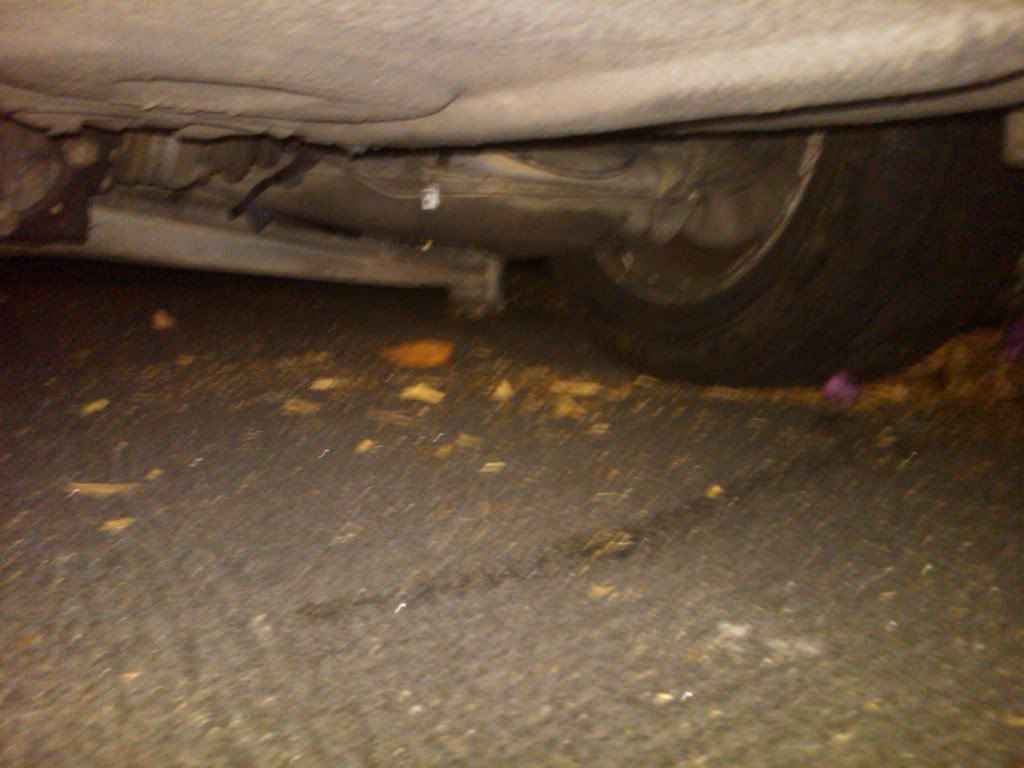

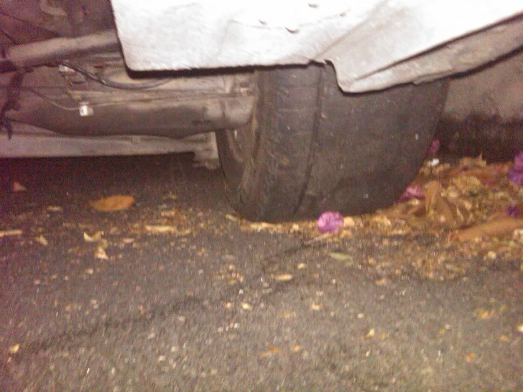

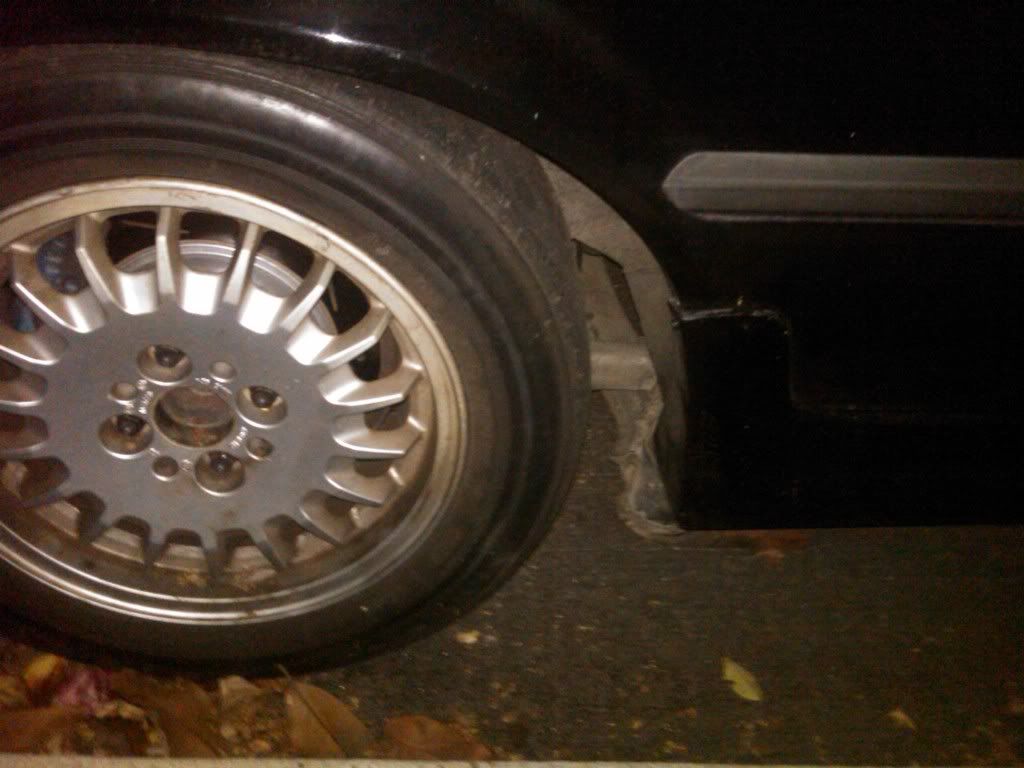

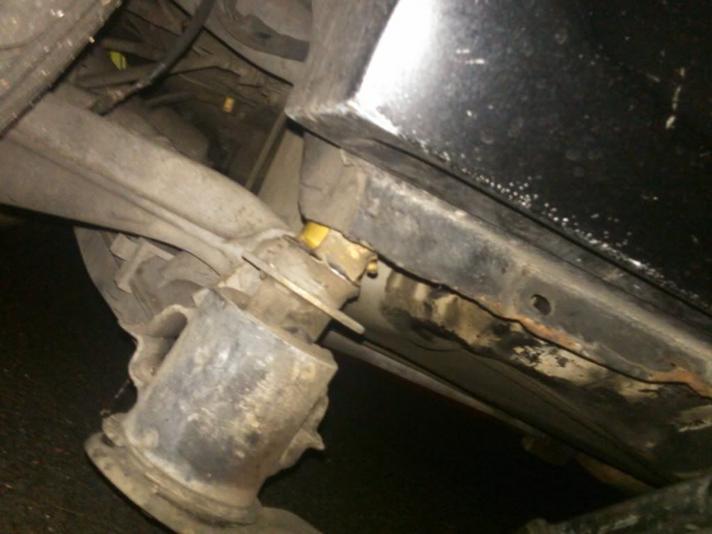

    Driving home, heard a * POP* , pulll over nothing visually wrong, roll out, *CRUNCH * look under and this...........
    I think its my 'subframe?!?!
    Yes the Sportmax wheel and old ass suspension outlast my cars frame, shit just cracked in half and fell down. I know its the shitty L.A. Streets/potholes/horrible pave jobs, plus my static stiff ass setup (no travel)+ old frame :(.
    I left it in a neighborhood for now.
    So how the frick do I fix this?!
    Weld job/patch job?!?!?!
    Please input, as I am freaking out.
    Passenger rear, right in front of wheel, underside.

      Very disturbing pics. Looks like it ripped the mount right off the body. Gonna take more than just another subframe if that's the case.

        That really blows :\ That is what stiff suspension does for you though. Something has so absorb the impact energy of bumps and in this case the chassis sheet metal fatigued and gave out.
        You may want to talk to some e46 guys and see what they have done/where they have gone to get things patched up.

          Not only is your subframe fucked, but those bushings look like they were way, way, way past fucked. With a stiff ass suspension, and stiff ass fucked bushings with no give, this is not surprising.
          Time for a new car. That's a subframe mount that ripped completely from the body. It's not going to be a quick and easy patch/weld job.

              imho the failed bushing caused your subrame to hit metal on metal each time the body tweaked, this combined with stiff suspension caused the weakest link to shear
              oh and in the spirit of r3v, just take your back seat out, get a long threaded rod with the biggest/massivest washer you can find, poke it through that hole that this carnage made...and bolt 'er back up.. then drive away doing like 40mph MAX :-D
