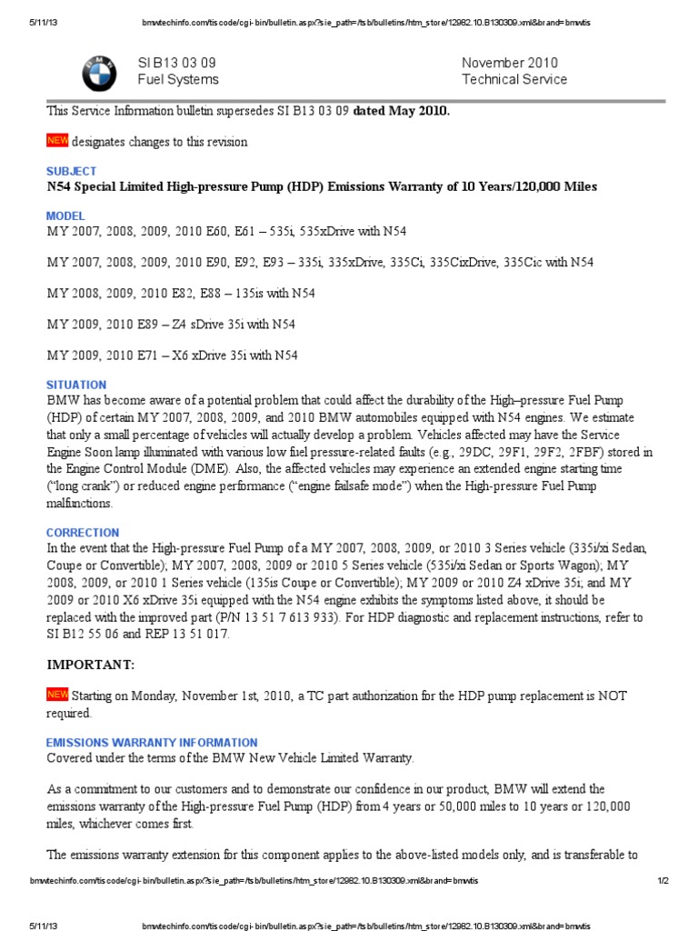

Owner of 6 bimmers view on 335i
  • nando
    • 34844
    #91
    535i's must have the same issue?
    want to replace the Subaru in the next couple years. either with a 530xit or a 535xit..
    Build thread
    Bimmerlabs
    • slammin.e28
      שמע ישראל
      • 12054
      #92
      Originally posted by nando
      535i's must have the same issue?
      want to replace the Subaru in the next couple years. either with a 530xit or a 535xit..
      Linky to a proposed class action lawsuit that pretty much lists the cars affected.
      ...and the TSB
      This document: Technical Service Bulletin advising warranty coverage changes for the High Pressure Fuel Pump in vehicles equipped with the N54 engine.
      • KHTRNAK
        • Jul 2013
        • 52
        #93
        Yes, it is a full on recall. Safety problem. Cars were just cutting off in the middle of the highway.
        Friend's ex had it done and there were still software issues persisting even after the recall. Many many trips to dealer = inconvenient.
        This is basically what I heard. I had a friend of a friend who worked at BMW and basically said any 335 that came in they just straight assumed it was the fuel pump. Said some were bad out of the box.
        '87 325is (Toy)
        08 Acura TL-S 6MT (DD)
        • nando
          • 34844
          #94
          Linky to a proposed class action lawsuit that pretty much lists the cars affected.
          ...and the TSB
          http://www.scribd.com/doc/153404704/...-Extension-TSB
          this isn't a good sign..
          total payment from BMW NA based on the number of HPFP
          Replacements obtained outside of the recall according to the following schedule:
          CBM-SF\SF534508.3
          Number of HPFP
          Replacements
          Total Payment
          1 $50
          2 $100
          3 $200
          4 $300
          5 $400 (capped thereafter)
          I think I'll stick with the 530xit :p
          Build thread
          Bimmerlabs
          • slammin.e28
            שמע ישראל
            • 12054
            #95
            Yeah, all that and they will always have the carbon issue every like 30k miles. Drop engine out, take off intake mani, walnut blast the valves, put it all back together, with new hardware of course because it's all aluminum nuts and bolts for Efficient Dynamics and has to be replaced each use.
            Waterpump is electric and costs over $500 and you have to use new hardware.
            ...and it's reliability track record is less than stellar.
            Call me bias, but the last good, in terms of reliability and ease of repair, engine BMW made was the M54.
            • Sirotto
              • 319
              #96
              Originally posted by agent
              335i has a 3.0L engine.
              They add the displacement of the turbos. .5
              "Socialism is a philosophy of failure, the creed of ignorance, and the gospel of envy, its inherent virtue is the equal sharing of misery." - Winston Churchill
              "People sleep peacefully in their beds at night only because rough men stand ready to do violence on their behalf" -George Orwell
              • Vivek
                attention whore/retard/bitch
                • Oct 2011
                • 6167
                #97
                Originally posted by sir otto
                They add the displacement of the turbos. .5
                Dude....no. 335i is just a name and has nothing to do with engine displacement.
                1992 Mauritiusblau Vert
                2011 Alpinweiss 335is coupe
                2002 540i/6 Black/Black
                2003 GSX-R 750 (RIP)
                • Sirotto
                  • 319
                  #98
                  K
                  "Socialism is a philosophy of failure, the creed of ignorance, and the gospel of envy, its inherent virtue is the equal sharing of misery." - Winston Churchill
                  "People sleep peacefully in their beds at night only because rough men stand ready to do violence on their behalf" -George Orwell
                  • Cabriolet
                    • 9620
                    #99
                    Originally posted by Vivek
                    Dude....no. 335i is just a name and has nothing to do with engine displacement.
                    WTFBBQ no
                    the 5 is from the fake .5 liter displacement that the turbos give. the actual engine is a 3L
                    so they call it a 335i
                    the NA version would be 330i
                    and the detuned NA is a 328i
                    all are the same size engine.
                    Much wow
                    I hate 4 doors
                    • Wh33lhop
                      • 11705
                      #100
                      Originally posted by einhander
                      What?
                      It's a BMW. It has A/C and a radio and sat nav. How is it not a daily driver?
                      This thread is an absolute jerkoff.
                      Ok cherry pick my sloppy wording would ya... Not meant to be JUST a dd. It works great as one, but it's also great on track out of the box.
                      And yeah it is, join the fun
                      paint sucks
                      • Wh33lhop
                        • 11705
                        #101
                        Originally posted by sir otto
                        They add the displacement of the turbos. .5
                        Nowhere on the 335 does it say 3.5, lol. They have just resorted to calling them whatever the marketing department decides... 328i 3.0 NA, 335i 3.0 turbo, 540i 4.4 NA, 545i 4.4 NA, 550i 4.4 turbo...
                        They have "massaged" the naming convention but nowhere on the car does it say 3.5 liters... They would get sued
                        Just spreading the pedantry. You're welcome
                        paint sucks
                        • slammin.e28
                          שמע ישראל
                          • 12054
                          #102
                          The 335 is because it theoretically makes the same power a N/A 3.5L engine in that trim would make.
                          Same deal with the e23 745i. It was a 3.4L with a turbo. Put out theoretically the same power as a N/A 4.5l engine in that trim would have put down.
                          They have done this before guys. Not big news.
                          e36/46 323is are really 2.5l. 328is are 2.8l. Why didn't they call it a 325i? Because why pay more for a 328i when a 325 is so close? Marketing. Make it look more superior.
                          • dannyyisntt
                            • 3141
                            #103
                            This thread is gay. OP, you are poorly informed. Do some research instead of spreading your verbal diarrhea everywhere.
                            • mikeedler
                              • 6707
                              #104
                              just wait until your warranty expires and you can start replacing each crappy made electrical component 1 after another, as well as the shitty ass quality of the motors in them-that will eat up a few sets of injectors, plugs, carbon up like a mofo, eat the cam/vanos seals (which will lead to new cam trays) as well as just fall apart in the interior.
                              yeah, they are fun to drive at work, but NO, I will never give up my hard earned cash for one of em. esp. a 5 y/o one..........
                              and BTW, you do not need to disassemble the motor to blast the valves.
                              are your waste gates rattling like a bitch at idle yet? no fear, they will start to if not already- and to fix that you need 2 NEW turbos.
                              The N55 is not any better of a motor IMO, has the same problems too.
                              and yes, I work on these things ALOT.
                              Last edited by mikeedler; 09-28-2013, 03:06 AM.
                              • einhander
                                • Apr 2004
                                • 2024
                                #105
                                Just for kicks...
                                My 335is is better than any E30.
                                /runs
                                2011 1M Alpine white/black
                                1996 Civic white/black
                                1988 M3 lachs/black
