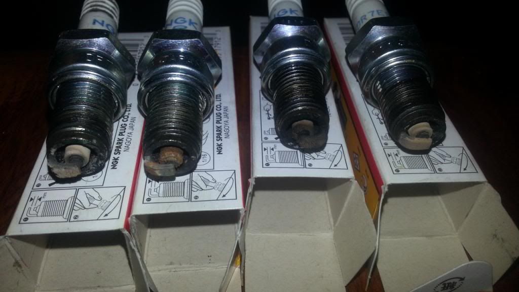

            Plugs in the order, 4-3-2-1 left to right

                      Be very "sterile" replacing the valve cover gaskets... They can and will leak oil into your spark plug holes.
                      Rockers haaaa! It seems like you've covered your bases, sounds internal. Head gasket & piston rings is a good place to start.
                      Rich!

                        Double check the plug wires, IMO. I had a cylinder die on my friend's m42. The plug leads would all spark when held against the valve cover, but with a spark plug attached, one of them didn't work.
