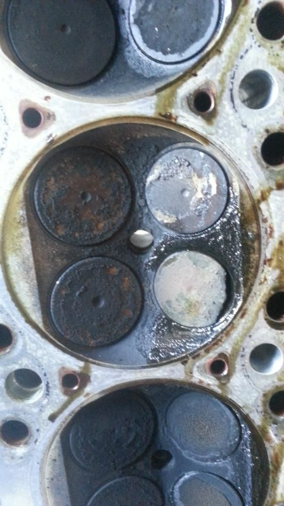

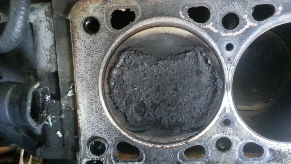

Quick update-I had a few minutes today so I did a compression test. Results:
Cylinder 1-180 psi
Cylinder 2-0 psi
Cylinder 3-180 psi
Cylinder 4-180 psi
So, good thing I brought her home. Next step will be pulling the head and inspecting. Will keep everyone updated.Comment
yikes that is a lot of burned oil on top of that piston , more than enough for major concern, looking at how the top edge is washed clean looks like oil is coming up past piston . i would be turning the motor over to put that piston at BDC and looking for signs of broken ring ,scored/badly worn cylinder walls . it think you might be doing an engine rebuild
what cyl was burned valve in ?
Burned valve was in cylinder 2. Already sourcing parts for an engine rebuild.Comment
