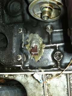

          I bought my car with 230xxx miles on it site unseen and drove it 17 hours back to Bozeman with no hiccups. The only time it has ever left me stranded was because of this
          Original owner (not the person I bought it from) stripped this sensor and jb welded it back in. I properly fixed it with a helicoil.
          The car has 248k on it now, just got a new suspension, and runs strong.
