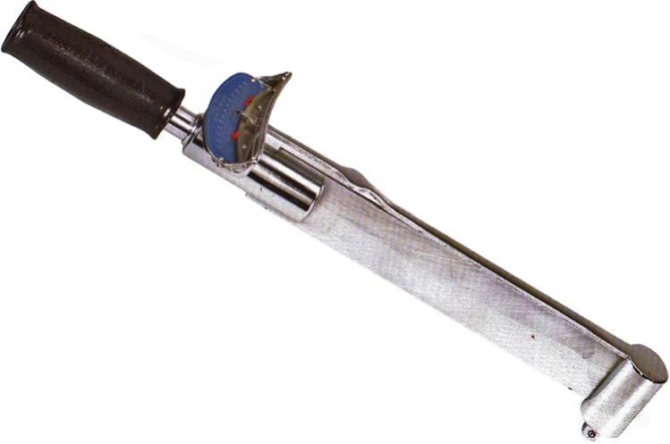

      Sturtevant Richmond beam torque wrench. I never worry about a click not happening.
