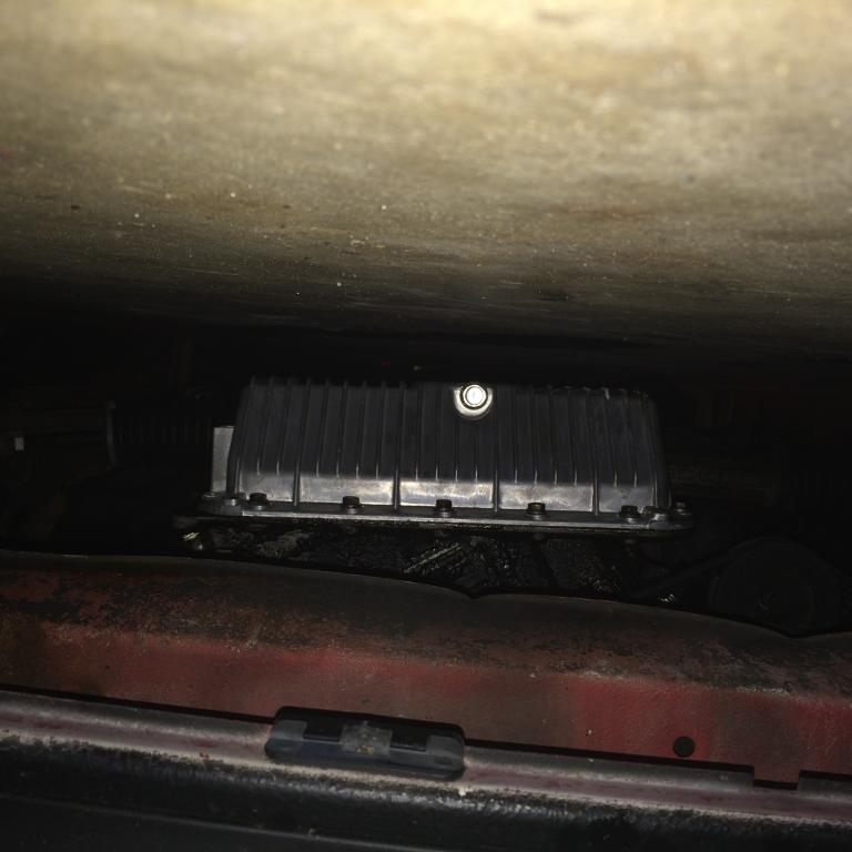

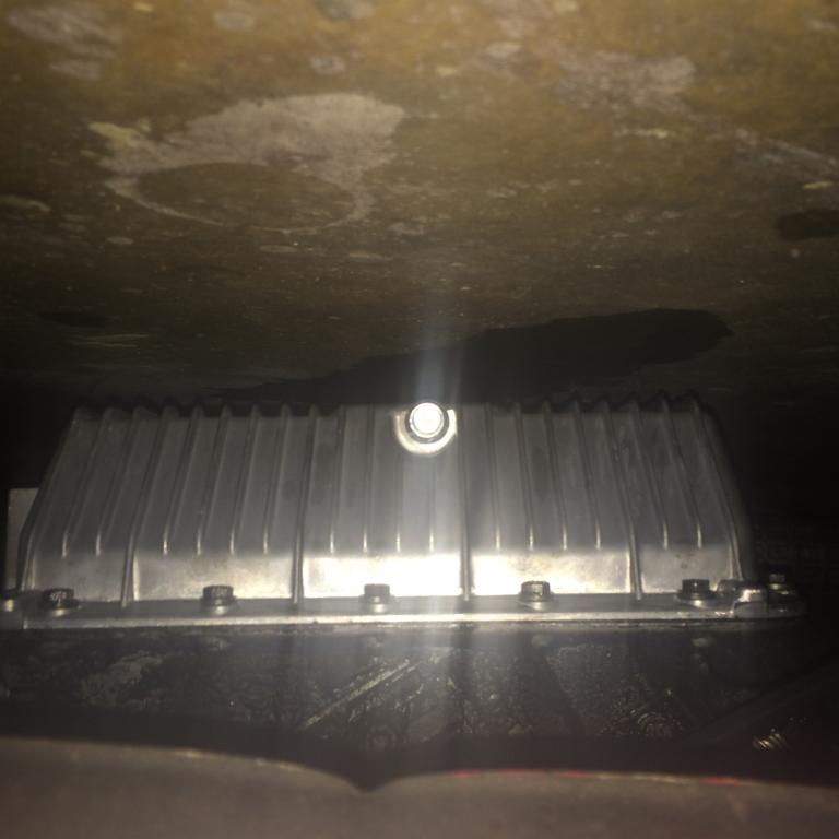

    I was looking underneath my car and realized that the oil pan is not straight.
    I bought the car pretty low. what would cause the oil pan to be tilted like that (in the pictures)? It just started leaking oil too.

    Bad transmission mounts maybe, looks like it's slanted from front to back.

      Ruined engine mounts. M42 oil pans are low to begin with, not a smart idea to lower a 318.
