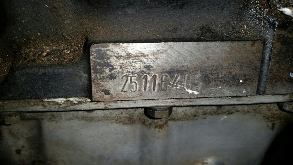

    For instance, I have searched up and down for these codes with no results.
    Engine Stamp = 25116405
    Block Stamp = BMW 1278 921 * 119

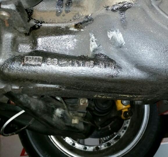

    Diff Stamp = 86 1410 BMW (4.10 LSD I'm assuming...)

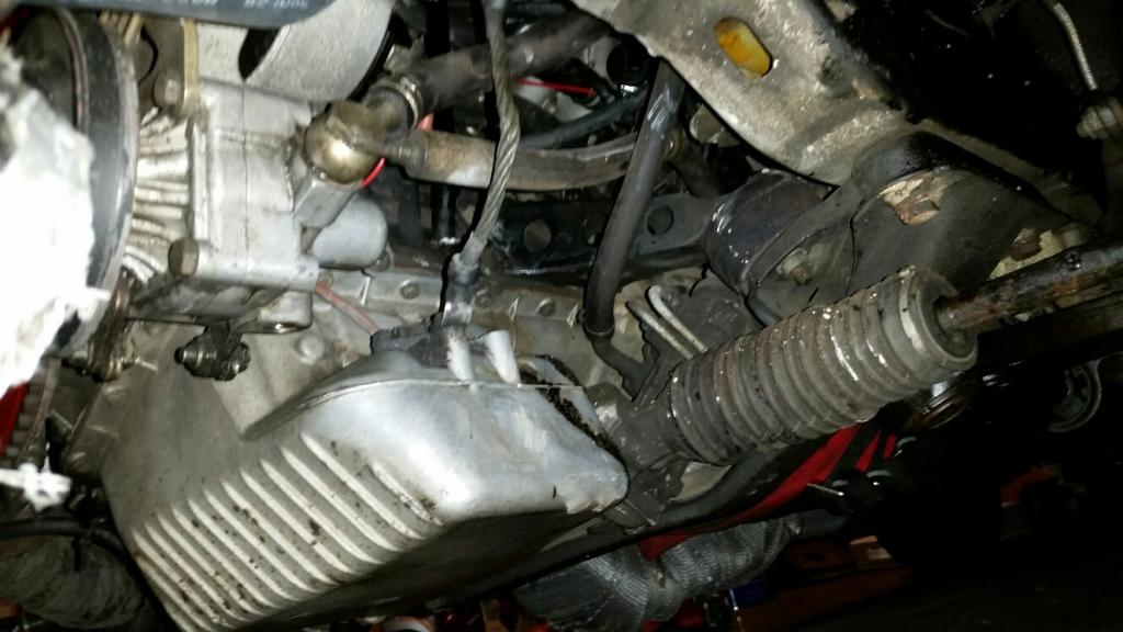

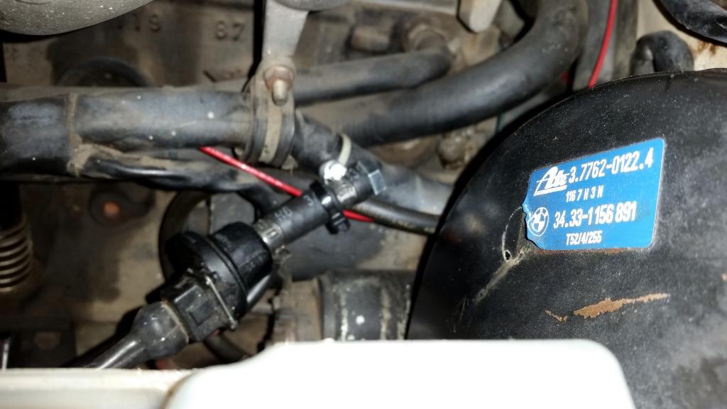

    Also curious as to what this is about? This mess is directly under the Throttle Position Sensor. Appears to be a spark plug used to plug something...some of not so quality things race teams do confuse me. This along with the Ozark water bottle that doubles as coolant overflow? I guess if it works...

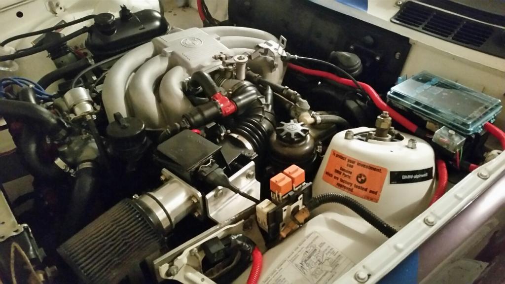

      Engine bay
          That's the evap purge valve, it goes between the charcoal can and the brass nipple on the bottom of the TB. Someone probably removed the charcoal canister/tubing because the line from the tank rusted out, or just for weight. The valve is there so it doesn't throw a CEL.

            There should be a tag on the back of the diff that says what the actual ratio is, but it could just be missing? Easiest way after that is to just calculate what ratio it is based on rpm vs speed.

                Here is the diff stamping. 1410= 4.10 LSD?

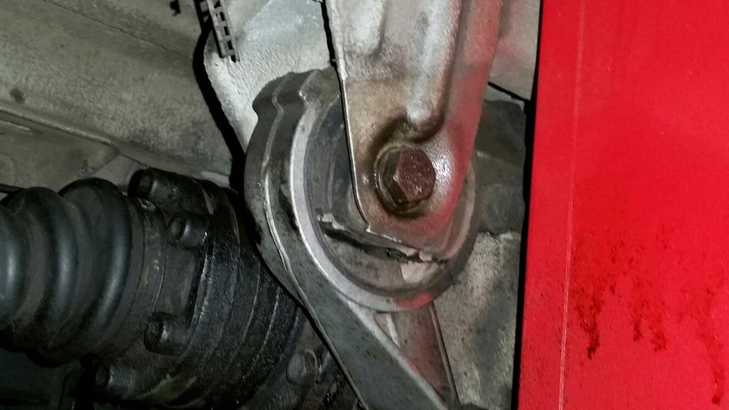

                  Few more pics...anything jump out as needing replacing? Anyway to determine if bushings have gone bad?

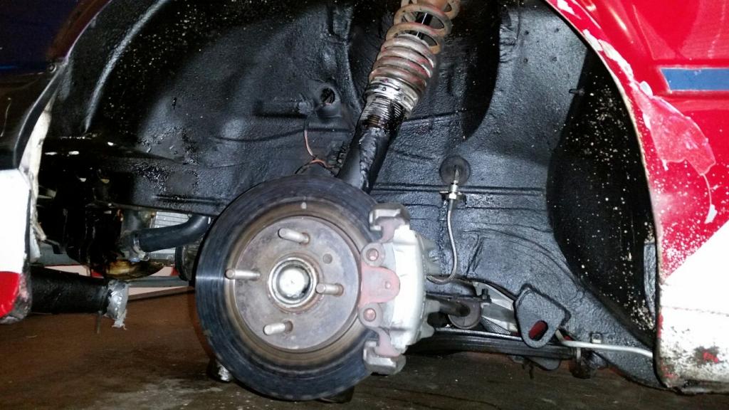

                    Brakes and springs..
                    Do these appear to be stock 325is rotors?

                          Does anyone have bushing recommendations for this car to be street/track driven?
                          Just ordered a Bimmerworld solid race shifter and they added that it may need engine and trans mount upgrades. Any recommendations on what bushings I should start with and what level to use (solid aluminum, 75A delrin, 90A etc.)???

                            The diff markings mean bubkus- and even if the tag was there, I wouldn't really
                            rely on it. Race cars get what they need, and the documentation varies from good
                            to non- existent.
                            If it's a track car, re- seal the brake calipers, maybe replace the master (if you can
                            figure out what it is) and PF08's.

                              As for the gear ratio, very simple when you think about it.
                              If you want to you can take off the rear cover and check the numbers on the ring gear.
