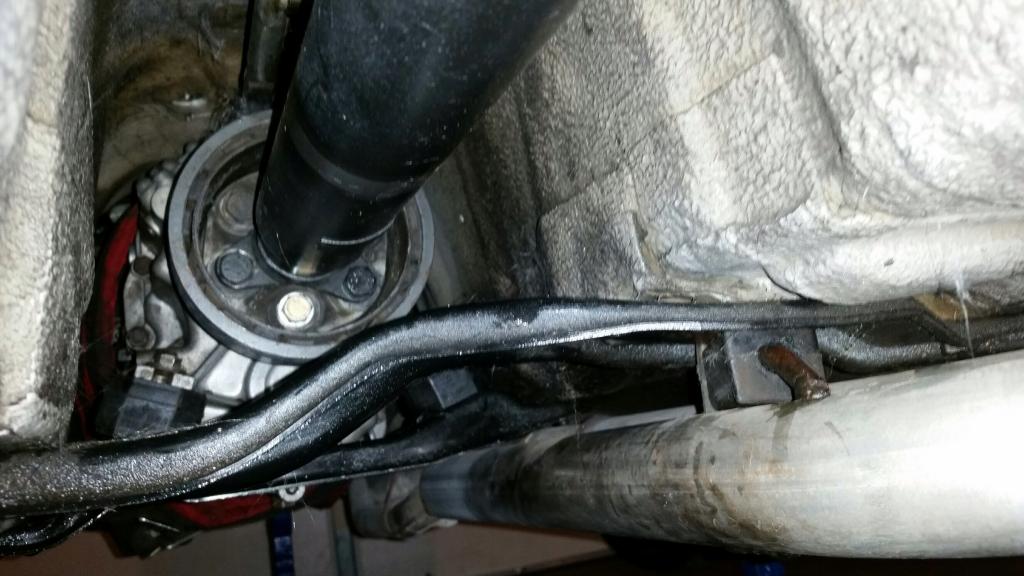

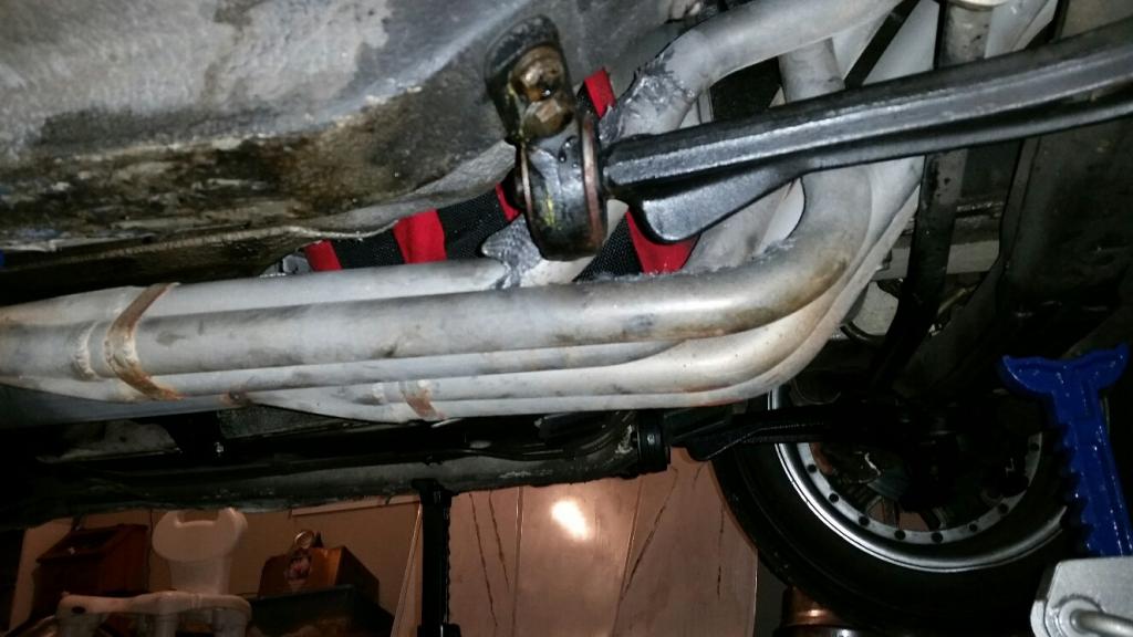

        #48
        Just got done under the car and found a few more interesting things...
        I am trying to install a new shifter arm and bushings, get under the car to drop the drive line and what do we have but the damn exhaust is attached to the cross member. Not great news but will have to figure out a way around it. Any ideas besides cutting away the exhaust?

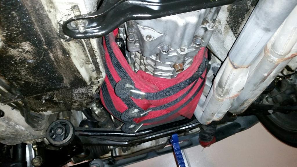

          #49
          Also noticed a transmission blanket...

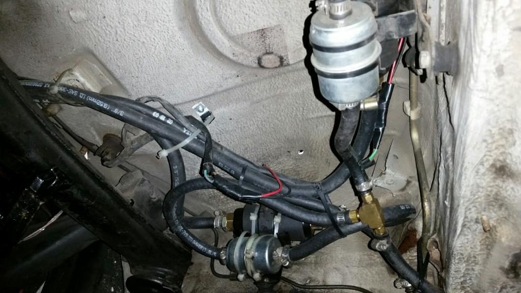

            #50
            Duel fuel pumps...
            • TobyB
              • Oct 2011
              • 5263
              #51
              Damn. Transmission blanket. I though putting them on poodles was silly enough...
              That's awesome!
              Do the fuel pumps pull from the crossover pipe locations on the tank?

                #52
                And even a little bag of snakes.
                This is oddly one of the more neat pieces of this car due to the story.
                These old beauties were fabricated by Alf Gebhardt. Mr. Gebhardt along with co-drivers Hans Stuck and Walter Brun won 1st place at the Daytona 24 Hour race in 1981, driving one of the all time coolest BMWs, the AC Schnitzer M1. Link of Mr. Gebhardt's racing history in BMWs here http://www.racingsportscars.com/driv...hardt-USA.html
                This is the type of thing that makes me feel nostalgic when around this car. Very neat detail and what a racing driver Alf Gebhardt is!

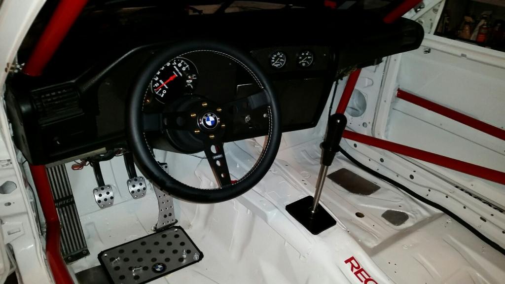

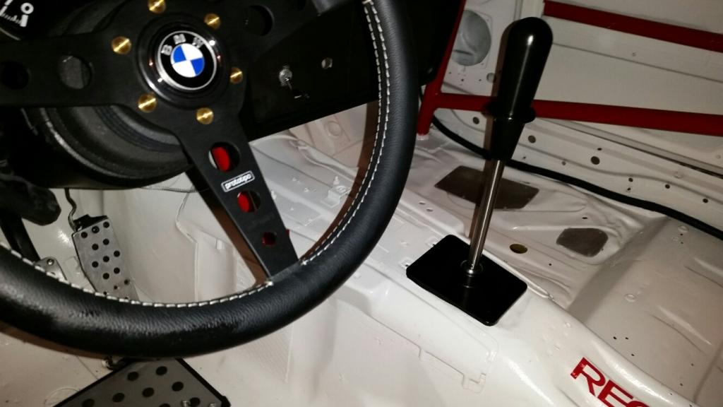

                  #53
                  Working on the new Bimmerworld Solid Race Shifter...I'm loving the hell out of the way this shifter shifts...
                  enter cliche here :)
                  • E92E30Nut
                    • May 2014
                    • 135
                    #54
                    I wish I could put into words exactly how this thing shifts...stellar
