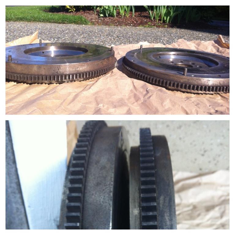

            And there's no way my flywheel is as big as the one on the left, in the picture previously posted, so that would most likely make it an early model m20 flywheel, correct?

              Did your flywheel have a metal stub sticking off of it axially? AFAIK 325e flywheels do, 325i flywheels don't. I have done this swap, I think you have the correct clutch and the wrong flywheel.
              This is my M20B25 flywheel:
              This is an M20B27 single mass flywheel:

                ok, those photos are great, i think my flywheel looks closer to the first photo, but ill call and ask first thing tomorrow to look for that metal stub to confirm if its a 2.7 flywheel.

                  If it's the B25 flywheel you may have just had the pressure plate misaligned. As I remember, if you have it turned the wrong way the bolt holes don't line up. I am unsure if you can use a B27 flywheel on an M42, it may have too much stacked height with the clutch and throwout bearing.
