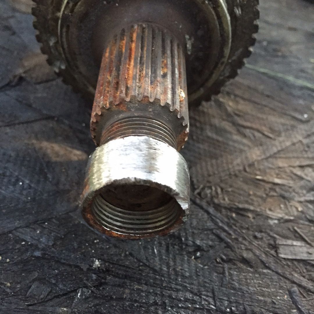

    Job: Getting half shaft back into rear hub (wheel bearing job, half shaft replacement, etc).
    Problem: Assuming your hub and half shaft splines are in good condition, the fit is very tight, and does not simply slide in, and the amount that it does slide in does not expose enough thread length to catch with the nut to pull the half shaft in.
    Commonly advised course of action that we are trying to not do: clean the splines with brass brush, clean hub splines, and if that doesn't work try identifying any burrs. Then magically become religious when you ask god for help when the half shaft still doesn't slide in far enough, and you start using a pry bar between the diff and half shaft.
    Speciality tool or technique to avoid aforementioned: "Ford Front Hub Installer" M22 x 1.5mm
    What tool does it that it goes through the tunnel of the hub, grabs on to the half shaft thread, and a socket looking push cylinder pulls the half shaft into the splines as you tighten the nut. Think of it as essentially temporarily extended half shaft threads by 8-10 inches. Literally makes the job COMPLETELY painless, really couldn't be easier.
    Since old fords are all junked now, these tools can be picked up for very cheap. Can be had for 10-15 bucks.
    Proof:
    A broader set that also includes an M24 x 1.5mm (to push front wheel bearing into shaft) is called a "Antriebswellen Einzieher" set or Drive shaft insertion set.

                      I eventually bought one of the ford half shaft yanking tools but prior to that used this
                      Crude but effective
