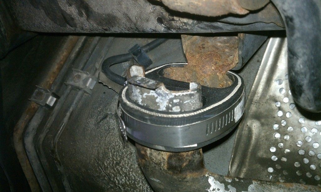

                This seems like a pretty ingenious exhaust hanger reinforcement.
                Aftermarket hangers are pretty weak now-a-days.
                    Seems that would defeat the purpose of having a rubber hanger since it wouldn't give.
                      The band would only be tight enough to prevent over extension.
