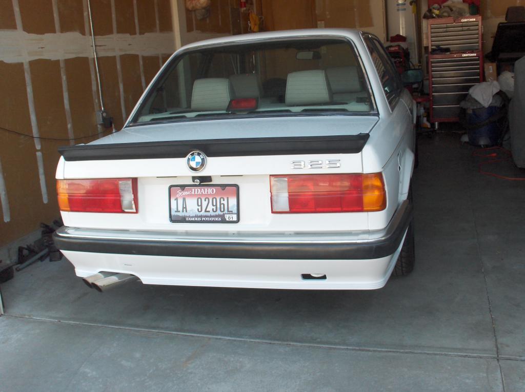

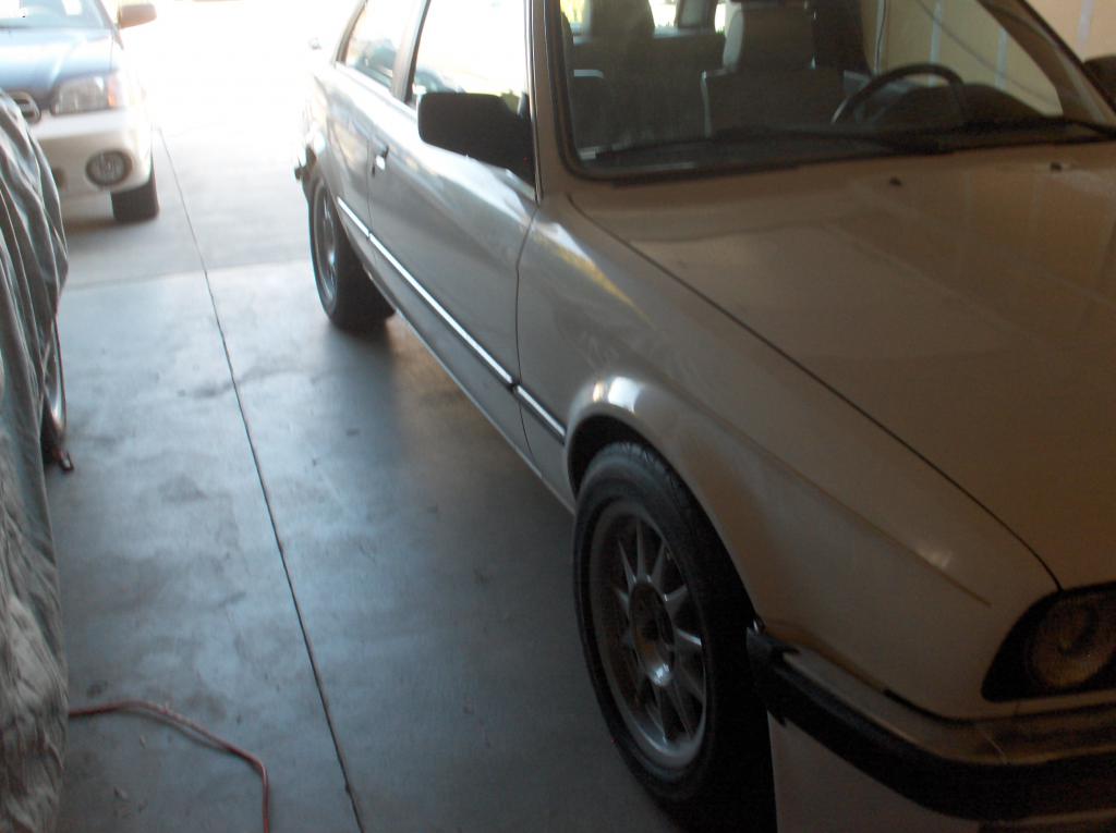

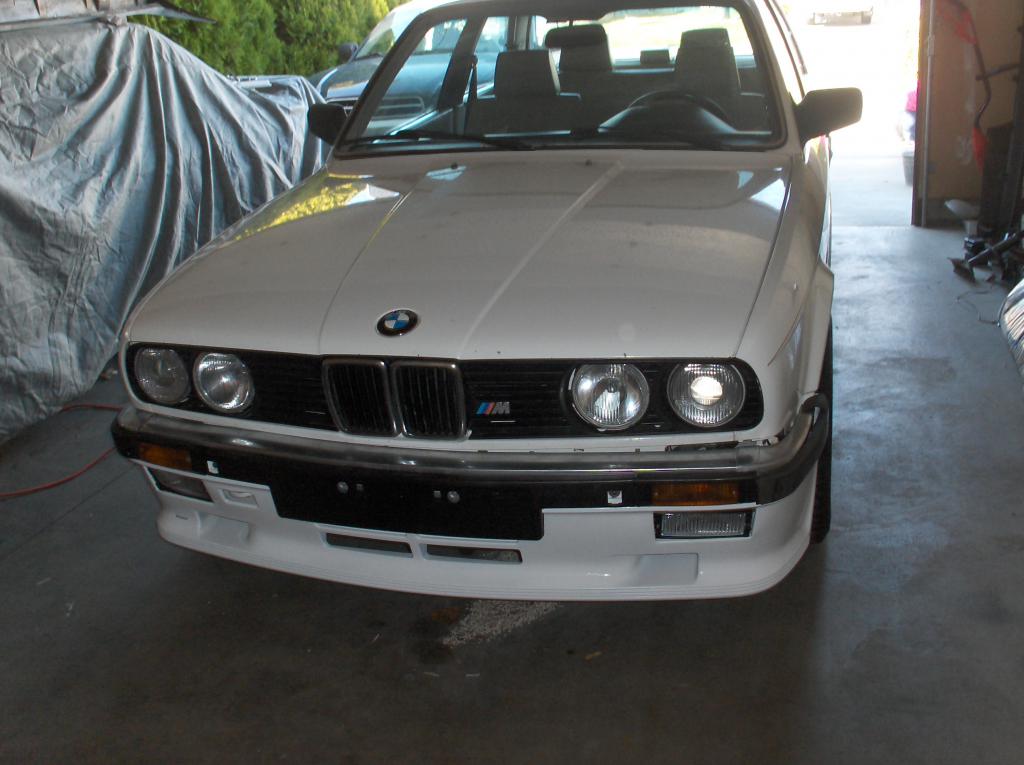

    here is mine
    Well, have mine about half way done. Sure would be nice to have a euro 323i. I think this kit would fit better:)
    Build thread may be put up once I get it all together.
    jm

      Fitment should be the same as long as you have an 87 or earlier US spec E30. Exception being the front inner steel valance which needs to be trimmed or swapped with euro to clear fogs/brake ducts on front mt1 valance. However, BMW also had 2 part numbers for the rear mt1 valance. One with strait back exhaust tips such as 320i and 318i, and the other for angled tips like all 325i oem exhausts. Note the different position of your exhaust outlet vs mine in the photo below. I am assuming that your pics show a test fit without everything buttoned up, but here are a few thoughts and pics that may help:
      Should fit about like in the below photos, note that you are using the standard euro bumper black plastic end caps on the front bumper and not the mt1 versions. You can do that, but need to trim off the lower tab
      side view
      similarly, rear should fit like this:
      One other thought, I see some open holes behind your rear bumper. these holes mostly associated with the us bumper should be sealed or caulked up as I think some may let water into the trunk.
      Here are a few photos during my install:
      Not sure if you saw it, but there is a really good rear euro bumper how to thread from 2008, most of which applies to this installation too. Here is a link to the thread:
