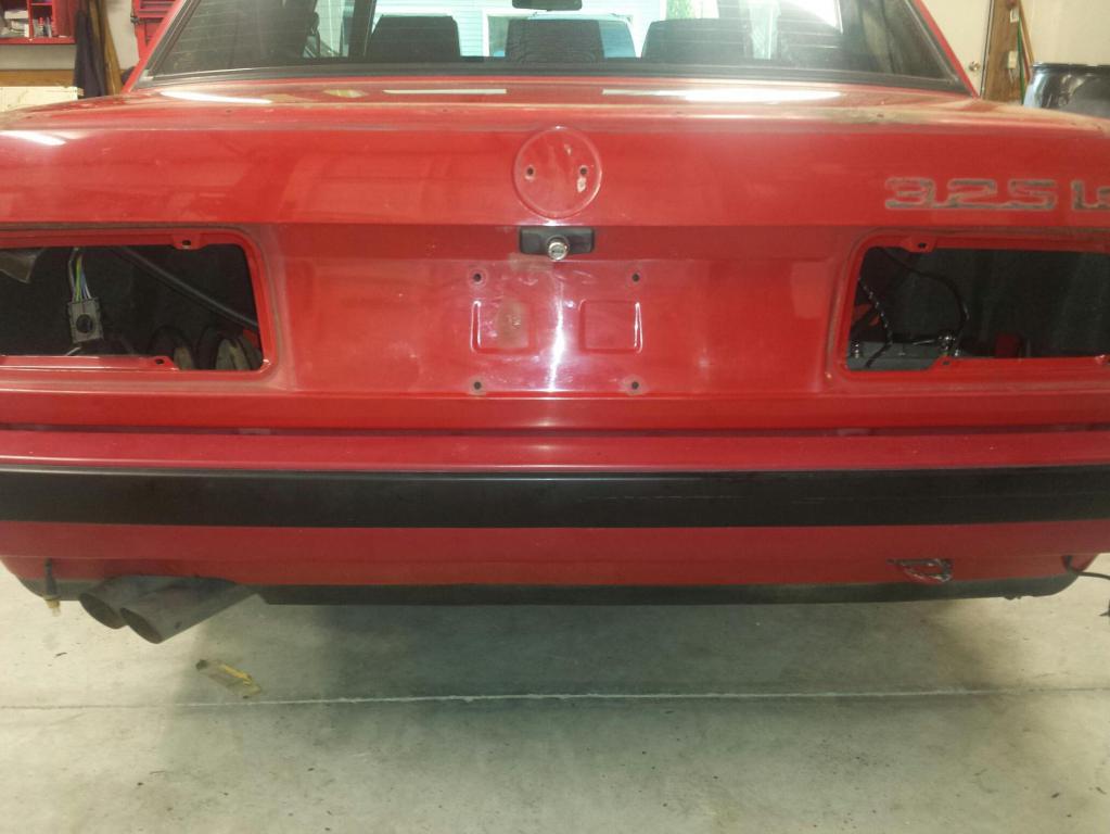

        Thanks. Trying to understand. Won't the plate filler cover the mounting holes in the body? Here's a picture of my car (currently being painted). How do mount the e46 bracket to the filler?

                OP, since you have a face lift model, you only need to drill the two top holes. The US plate hangs over the bottom lip of the body on the face lift models which may be of concern especially if you have a frame. I only used the top 2, I then removed the bottom inserts from the body and covered the remaining holes with tape. It'll become clear what needs to be done once you go to install the filler.
