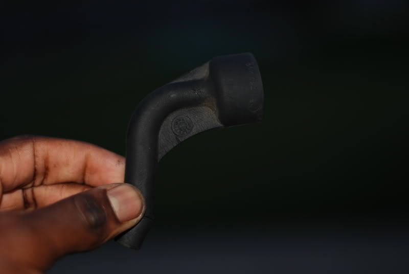

    So...In checking the engine bay for vaccum leaks...I found this:
    Where does it hook up to?

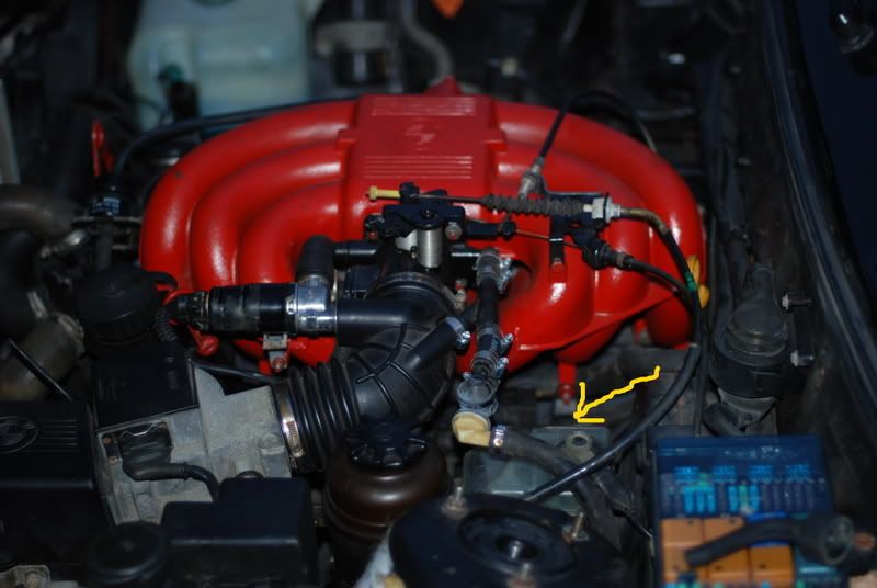

    Its located around here:

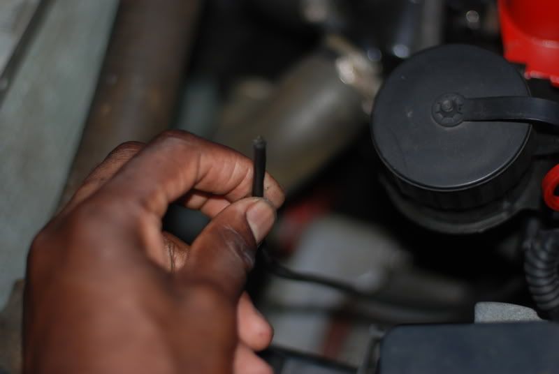

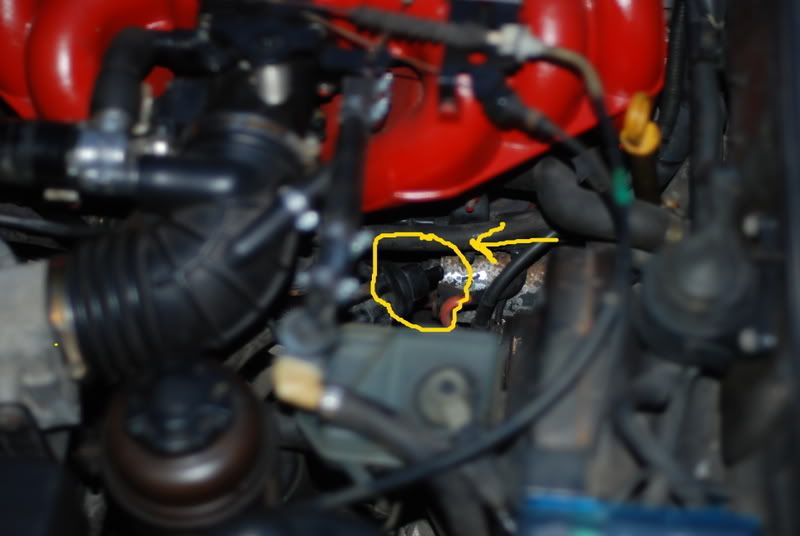

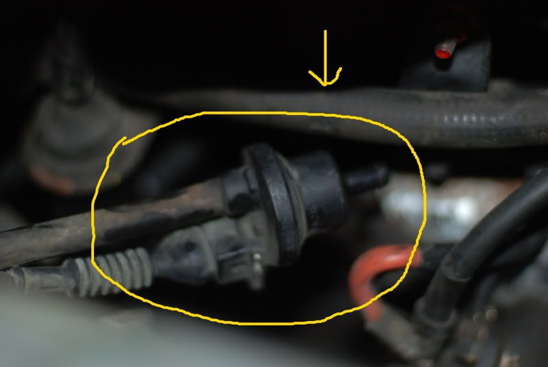

    Also..found this...where the heck does it go?
    Any help is appreciated!

      • speedhop
        • 1509
        Purge valve for carbon canister.

          • Julien
            • 7471
            it attaches below the intake (is your idle all funky now?) second wire looks like it is the strap for the spark plugs (goes around the front/top of the motor, attaches around a spark plug wire).. or if the car isn't running, then it's from the pulse generator by the lower harmonic balancer (big metal wheel with teeth on it)

            • reelizmpro
              • 9554
              Charcoal canister to the nipple on the bottom of the throttle body. IIRC

              • Dragowl

                Yes my idle is funky...has been and I've been looking for the culprit...so does it attach to the charcoal cannister or to the intake?
                Do you have a picture of where the second wire..goes? I'll check my bentley...the car is running...idle is rough, it actually sputters
                • delatlanta1281
                  Dart Master
                  • Mar 2006
                  • 10317
                  Not sure about the wire, but the tube with the nipple attaches to another nipple attached to the bottom of you throttle body. It is a pita to get to, but when it is on just use a zip tie to keep it from slipping off. Make sure it isn't cracked anywhere as well, or your car will still act like there is a vacuum leak, which.... there is.

                  • Dragowl
                    • 287
                    Good tip...I'll be sure to square that up...this explains the rough idle.
