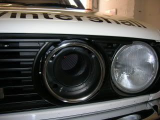

        I removed the headlight, ran piping directly into the stock air box, and replaced the air filter with a Pipercross foam panel filter. It rains plenty here, and i have no problems at all. But i don't know how water could possible get in the air box and up through the air filter without either A) being obstructed by the screen i placed where the light would be, or B) draining out the drain hole at the bottom of the air box. Your situation is obviously different, but i wouldn't think a terribly large amount of water could get through the filter if you have a screen in the hole. If someone in front of you runs over a big puddle and you don't have anything to block the water, though, you may have a problem.
        And for the record, i did the high beam removal/piping shit because i was bored one day, not because i thought it would make my car totally fuh raze or give my any hp gains.

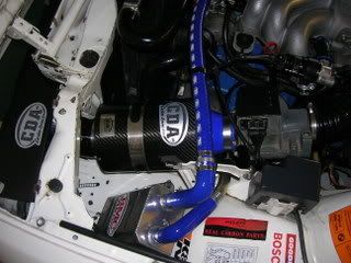

              I noticed alot of people have said not to rip out your light! So i probably shouldnt post up this picture!
              I can hear the brains bubbling away with excitement already!

                meh, my car came with both high beams deleted and screens. it also is a 2.7 stroker, ford maf conv, dbilas ITB's , camzilla. i put a prefilter over the cone, that helps with the water. need to build a heat shield though.
                i like the way it looks. what evers. it is my car, not yours. i did put a W123 fog in the pass side today. not sure if i like it not being symmetrical though

                    I still contest that all the CAI haters on here are hating, because most people do a half-assed non sealed off intake system.
                    I know the custom intake we built on my 300Z made a noticeable difference. But it was also sealed off to the outside "fresh" air and the stock location placed the air filer directly behind the radiator.
                    And CrazyGhost, I am intrigued because I've been looking at the CDA boxes for once I go with the M30 AFM.

                        I had my high beam taken out for a while for a while and needless to say i now have it back in. One of the negative side effects i had was the engine bay getting filthy with all the shit that would fly in, even with a screen over the high beam hole. I live in Vancouver British Columbia and we get a hell of a lot of rain and the only issue that created was water all over your engine bay. That and people asking me all the time "why is there a light missing". I also seem to remember reading some where that unless you were going at least 100mph that you would not see any performance gains.

                          I have my filter directly behind my removed highbeam. I have noticed that I need to clean the filter more often but the response is nice. As to the intake temps, I have not been able to log, but when I pop the hood and place my hand on the intake it is cool to the touch. Before it would be warm to hot.
