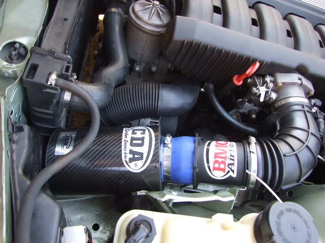

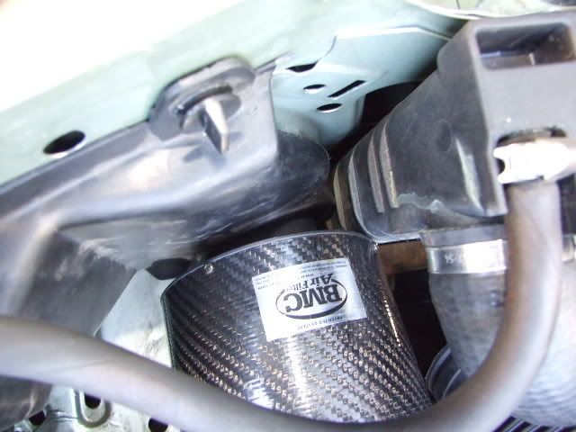

      And CrazyGhost, I am intrigued because I've been looking at the CDA boxes for once I go with the M30 AFM.
      Ran My M50 intake like this. (Ignore the wire just a temp gauge i hooked up to see the difference between BMC n Pod) Go to your local auto shop and get some silicon tubing that goes from 2 inch to 3 inch. 2 inch on the end of the BMC and the 3 inch opens up through the back of the black plastic headlight rear cover! Snug as a bug!
